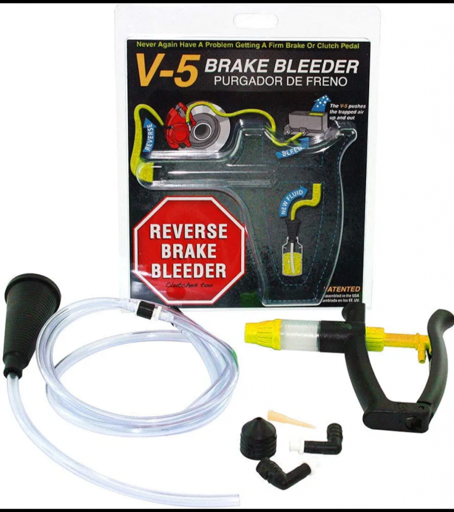

You can thank me later. Having the correct parts is on you.
