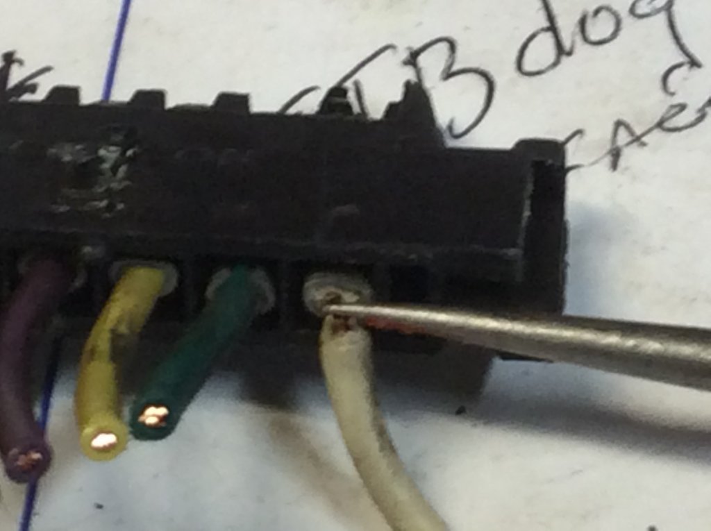

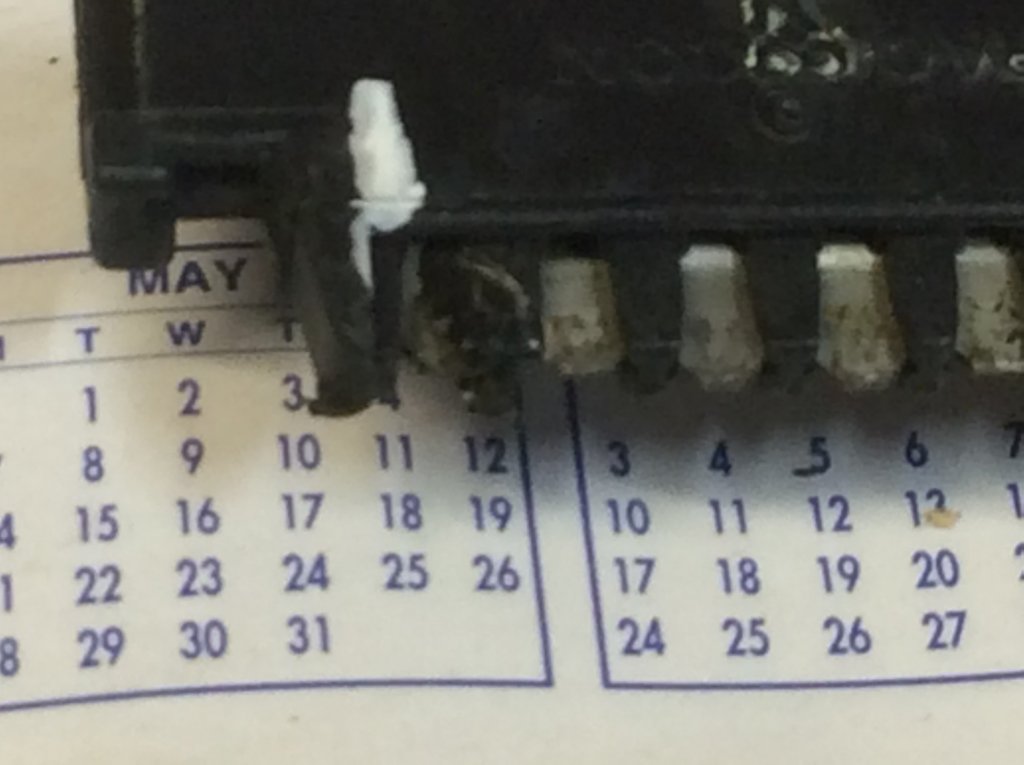

success!!! got the brake lights back and everything else is working!!new turn signal switch did the trick!! Turns out the white wire on the switch side of the connection was broke and had melted down at some point. thanks again for all the info!! now on to a new master cylinder!!

Broken wire and burnt connection!
