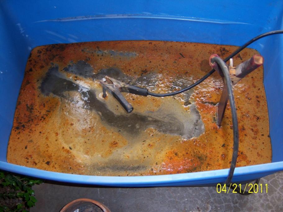

Sumbish its working good. Bubbles are coming up all around the head, and the water is even moving in a circulating motion. This thing is cookin !!! I think its gonna be good good good !!! I sure hope, my expectations are going up. This was 18 minutes in.

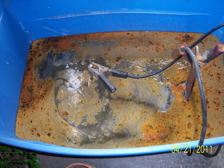

30 minutes in. Bubbles galore !!!

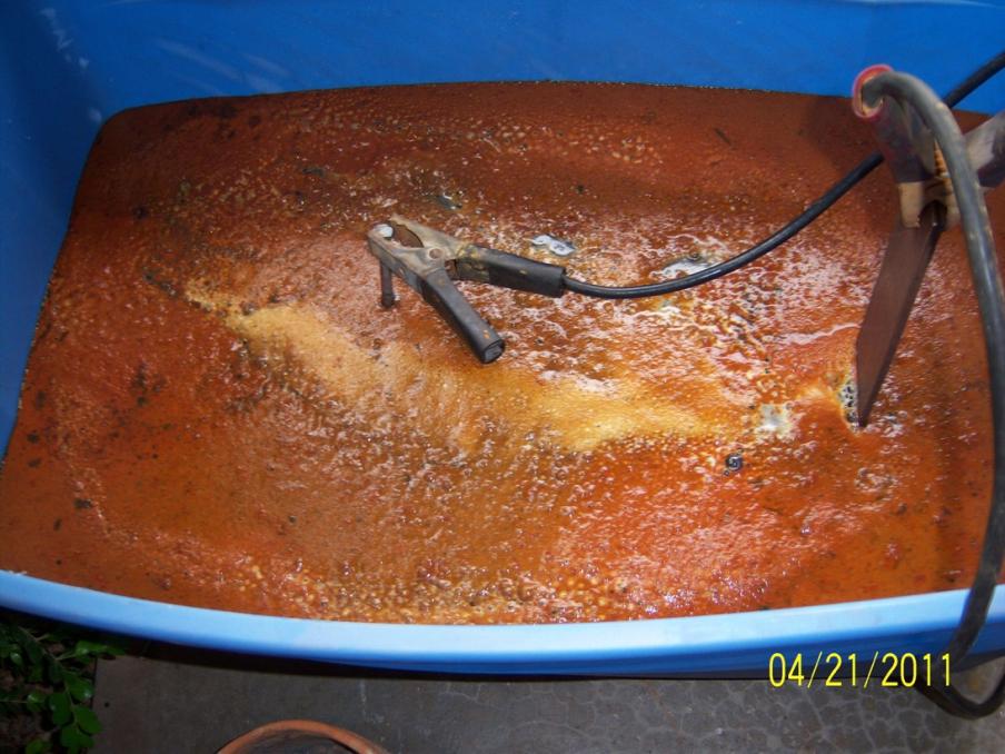

An hour and a half in.
You bring up a good point 89S, I wonder if there is a way to skim that stuff off, and it would make a difference. As you can see now, if it needed oxygen, its getting choked off now.

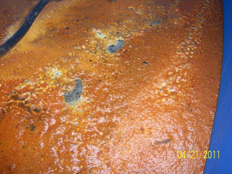

A close up of the **** !!! Its still showing mega bubbles flowing, but I can only see them in what couple small areas are left and not covered with floating rust. I think the clean areas are only there cuz of the moving bubbles pushing the rust away. Think I'll wait to the 2hr in point, shut it down, inspect, flip the head, and clean the steel and start it back up again.
