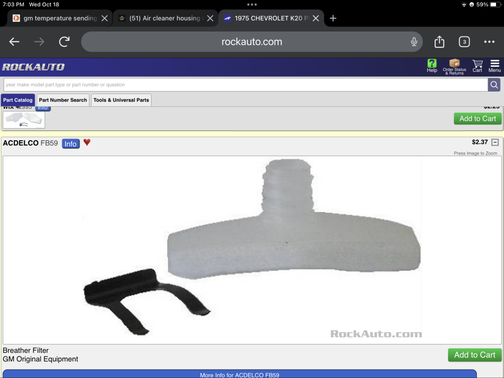

This picture below is the filter and clip. Then you need the valve cover fitting, which is just a short metal connector, and the short hose that prairiedrifter shows in his picture. A visit to pick and pull will get you a valve cover fitting the quickest, since they were used on many GM vehicles.
