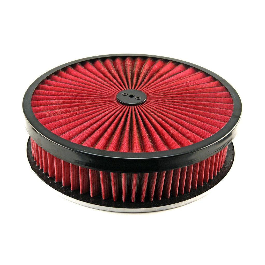

Do you guys watch Engine Masters? They had an episode that compared pulling air in through the top of air cleaner like what I attached, versus a stock type that forces the air to bend 90 degrees first. Pretty big difference without the bend.
As far as cool/hot air, that depends on they time of year. Here in michigan its cold 9 months out of 12 so I don't see the "heated" air as an issue but do understand the concept. I know this isnt exactly like flipping the lid but it would be cool to see the dyno difference in a controlled environment with hood temp out of the equation.

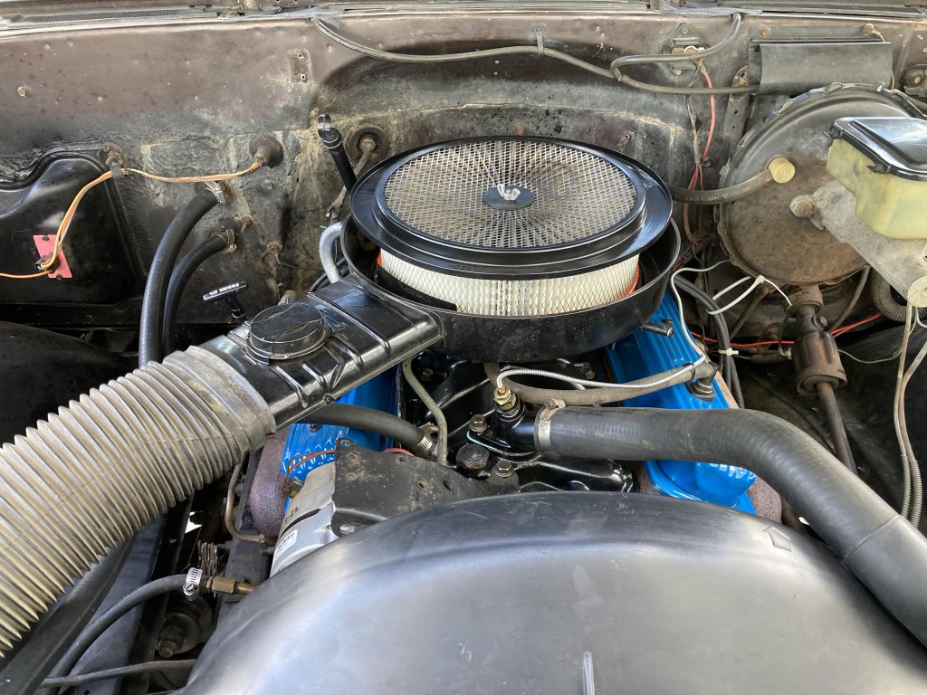

One thing to add, I am using this setup. I still get some outside air in, plus the top down affect and the flipped lid affect. I just did a trip from MI to Pittsburgh (355 mile) in my '85 C10, 350 motor with Q-jet, 350 turbo trans and crap rear less than a 3.0 ratio gear. I tac 24-2500 rpm at 70. I went 65-70 the whole way there and truly and accurately got 17.5 mpg the whole way. Not sure what other folks get with this setup but I was happy with that. The motor is a '91 350 though.
Id imagine certain muscle car hoods of the era based on functional vents or openings and shape would potentially benefit from that, a truck, only like how it was shown with the base still snorkeling to the core support. that supplies the cold air and the increased surface area supplies the air to the capacity it will take
