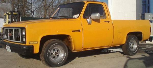

Thanks Bucket. What are your thoughts for a paint job ? Im going back and forth between the colour it is now or Chevy orange. I was also thinking of getting stickers made for the doors from my brother in-law say " The redneck express "
31,117
30,401
What color was it? Orange always looks good on these trucks, IMHO.

This is the colour it is now

That's a good color too if you ask me.
