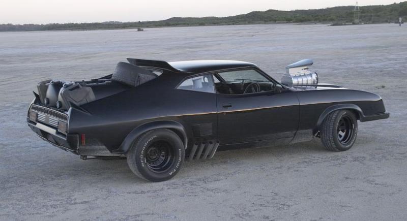

Hmmm yeah thats a good point. what about exhaust like mad max's car from the road warrior ?
Before i forget the only 4 letters i could find on the computer were AWSY

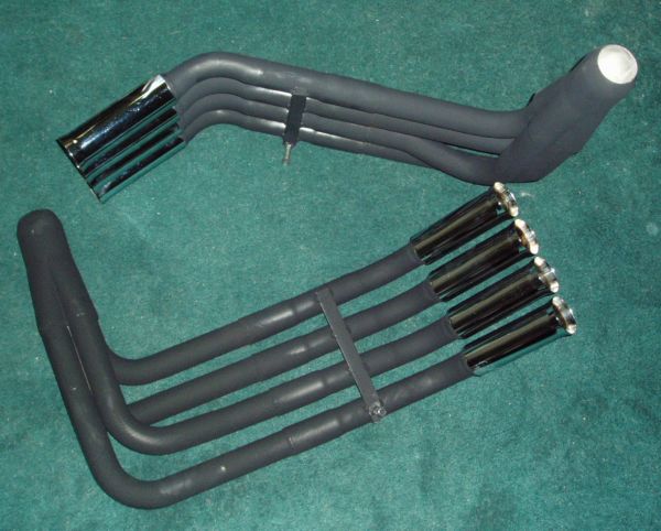

This would look BAD ASS !
