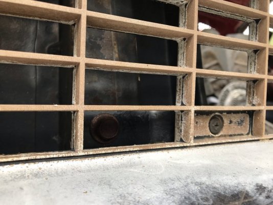

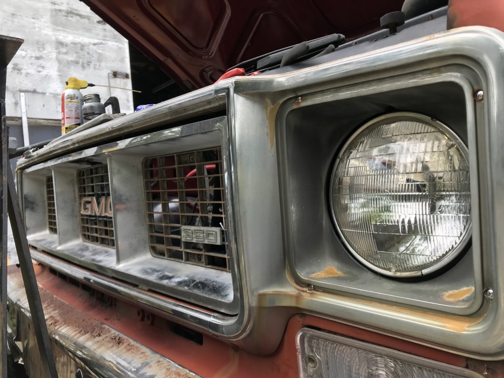

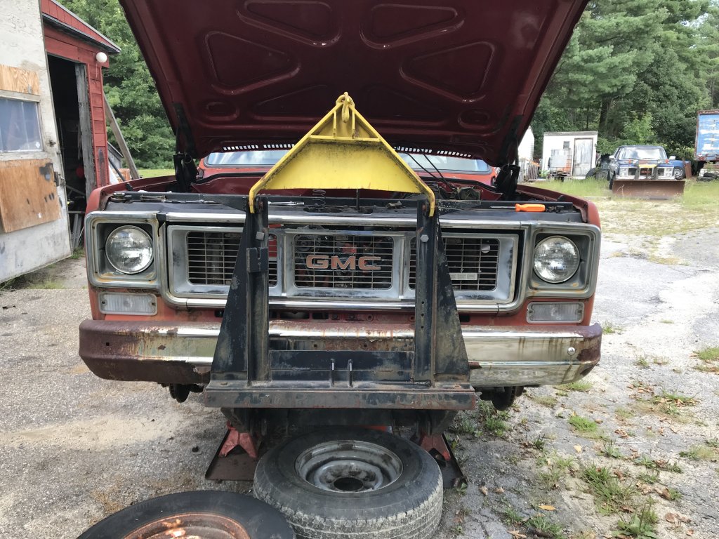

Came out great. Very happy with the look. I ordered the center and outer brackets new from lmc. The center bracket is just swap out old install new type deal. The outer brackets I needed to drill mounting holes in the core support. But there were dimples in the core support that were the exact location of the bracket bolts so that was easy. I removed the two mid way brackets that fit the 76 grill and made two little support brackets to help hold the grill steady. All in all I have 6 out of the 8 bolts holding the grill in and I think that’s enough. I one of the pictures you can see the offset brackets I made to utilize the 76 mounting holes for the 73 grill.

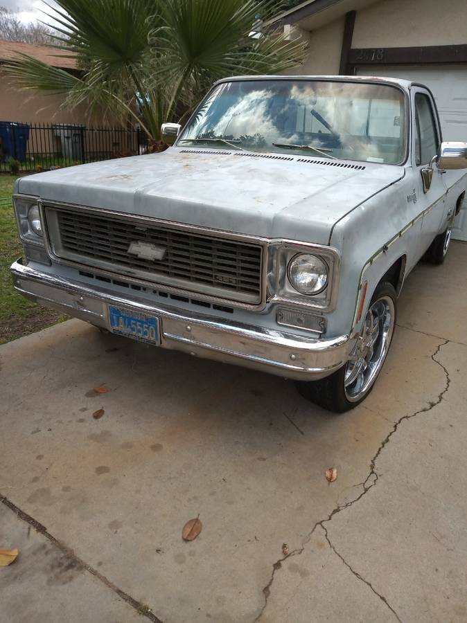

my dads 76 silvy has 73-74 grill didn't do anything as far as mods. wonder why smh...it was built 75 but sold as a 76...
