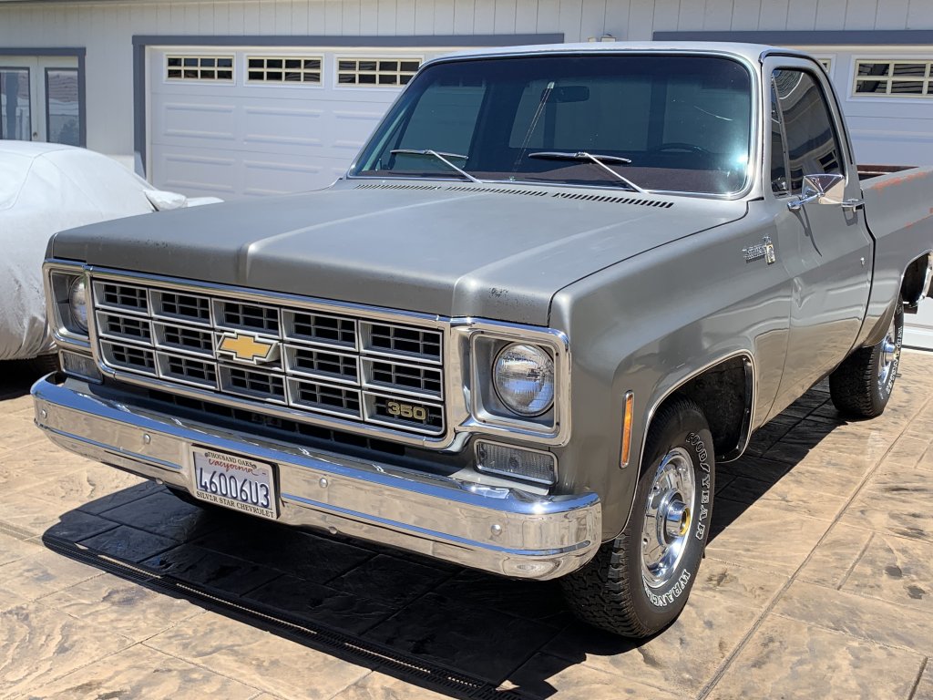

That surround is 1979 only. The only year for round eyes with the signals incorporated into the surround.
Also, my uncle had a '77 K20 w/400, and he bought it new that way. I believe that 1977 could have been the last year of the engine displacement in the grille. I don't recall seeing them in '78, and I know the '79's never had them.
That surround is '79, and also '80 without the chrome grille option. The hood is '73-'78. If I saw the underside of the hood, I could say if it was specifically the '77-'78 version or not. The grille is '75-'76.
I won't bet the farm on it, but I'm 99.9% sure that the engine call outs were not used at all after the '76 model year.
