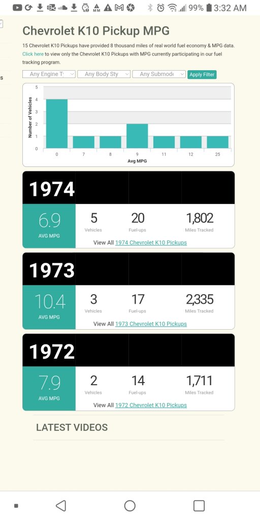

Okay he has mystery gears, no speedo, non working vacuum advance, at the very least,a vacuum leak which will make it run rich, pulling fuel from the enrichment circuit,because with low vacuum conditions the carb thinks he's in the throttle all the time. Who knows what else is wrong.We have pages and pages of guys saying you cant get better than 10 out of a good running square. You look on fuelly and at random the K's that I looked at,don't get stellar milage. Lets quit arquing about what his milage REALLY IS or couldn't be etc. and help him fix his problems.
