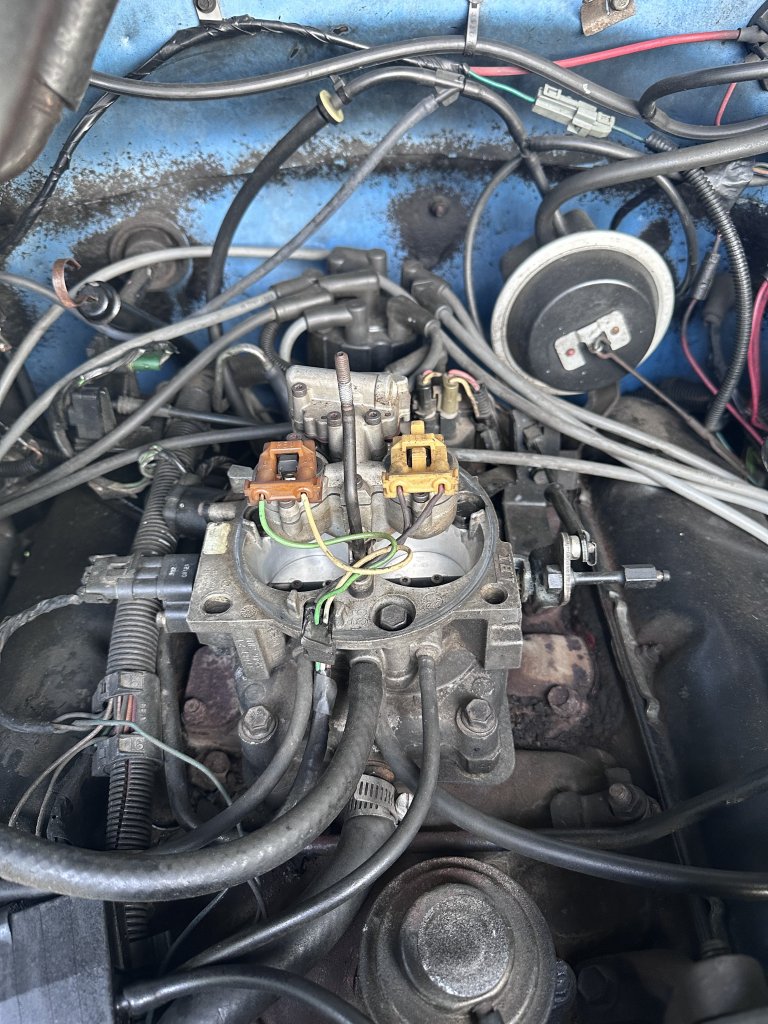

I watched the injectors revving the throttle by hand. Passenger side looks not as good, but not god-aweful enough so the engine only makes 75 hp or so.

The side with the original injector plug is spraying like chit.
The newer connector side (aftermarket so no color coded wires) looks much better.
I’d call that an issue.
And reasonable that an almost 40 year old injector could be plugged worn or faulty.
Who knows if the injector was replaced along with the connector on the other side?
Maybe the revving you hear is the downshift and it’s not slipping but just no power like your original assumption.
Slippin trans is unlikely if you say it pulls hard and shifts fine at lower % of load.

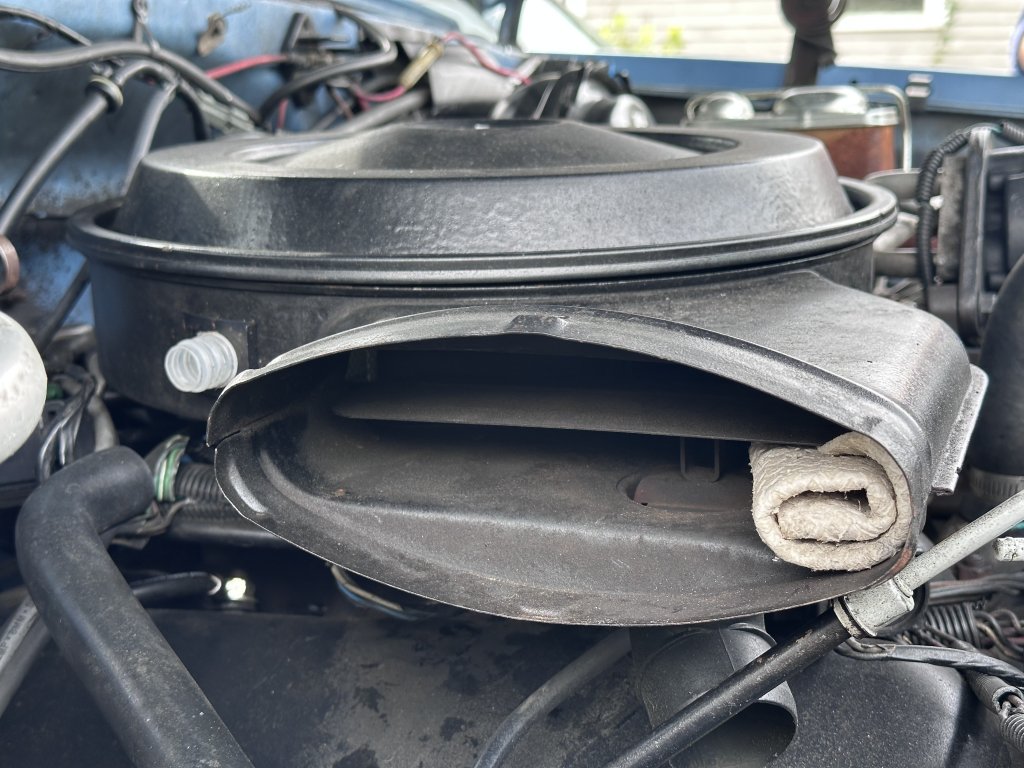

So following up on the solution. The thermostatically controlled flapper on the air filter housing didn’t have the hose running down to the shroud on the exhaust manifold to supply heat and open the flapper. So the engine was choked for air. I wedged a rag to hold the flapper open and it runs 100% better. Trans shifts fine.
I’m going to look at aftermarket air filter housings without the snorkel/flapper I think.
Also, I’m going to go ahead and rebuild the tbi/regulator/replace injectors since I bought the parts already.
