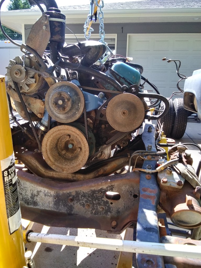

A little help fellas, my 56 yr old brain dumped some 1980's files. Drivers side motor Mount is not lining up..... WTF over??? I put a 454 in my 74 K20 back in the 80's. If memory serves me right it dropped right in???

This 78 K30 Frame was a small block truck.
