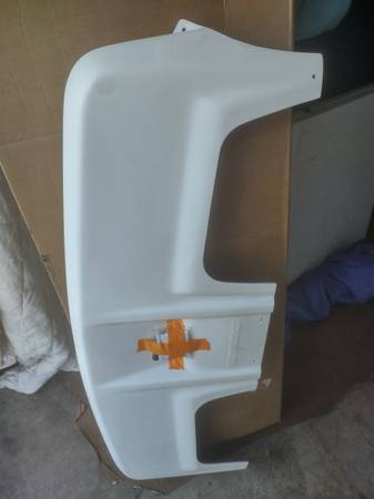

Pete, if you ever find a moon visor like that for a square body s10 PLEASE let me know!!!!!
There is one on my local craigslist now....
78C10BigTen
Apr 12, 2017
16,425
27,036
pennsylvannia
Ted
C10 BIG TEN
Looks like a round body s10 (maybe not.) and without the lights. Thank you so much though!!!
