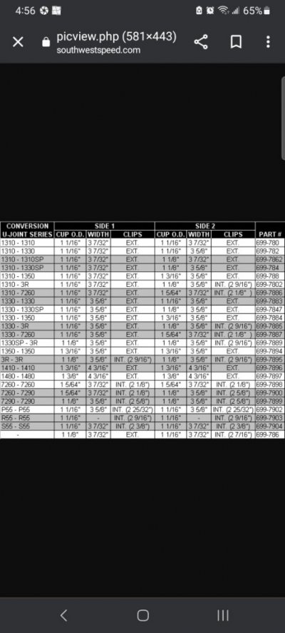

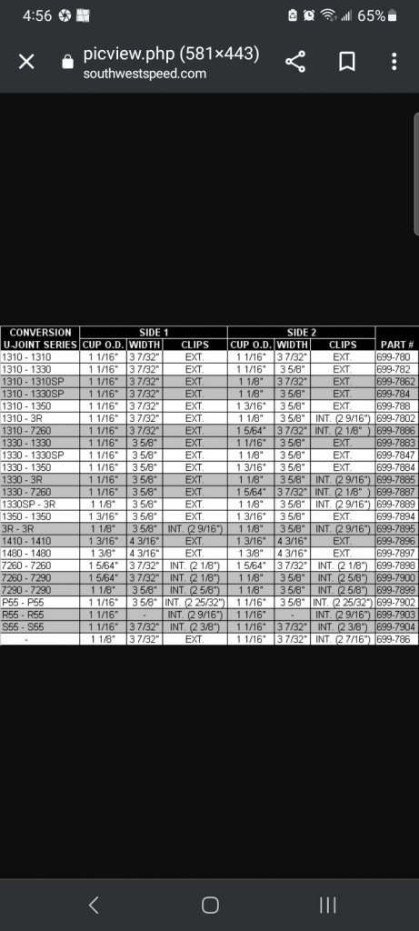

Is it really sliding in the straps? Or is the Ujoint cross sliding back and forth inside the caps?If it's sliding in the straps I would assume mismatched parts. Been down this road 3x times all three took research to get a ujoint to fix them,don't remember them all,but I think it was precision that has a chart listing ujoints by width,both directions,cap diameters,and retention methods. I was able to find the joints I needed all three times. Found a chart I found a bigger one b4 I really think it was precision brand. And after thinking I remember all 3, a 79 trans am with a 9 inch a 66 chevelle with a mystery rearend and my 75k with mystery everything.
