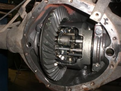

That gov lock.. Is it worth keeping? can a person rebuild them ? any more info on it would be greatly appreciated.. While changing the diff oil tonight i found that i have a gov lock . This is going to be mostly a farm and bush truck.. i would prefer a tight posi over a locker as its easier on them when you have a load of fire wood or a stack of hay..
47,140
9,346
I'll go out on a limb and against what everyone else is likely to tell you, but hey, I got balls so I'll take the heat. In all honesty, it's true the Gov-Lok is a hunk of ****. But, I've seen an 80 GMC 1/2 ton 12 bolt with one that worked perfect just before I sold the rear end a few years ago and who knows many thousands of miles were on it. I bought it from an old man who bought the truck new. I've seen it in 2 different Full Floaters and it was in good shape and worked well. No, it's not the most favorable of Lockers/LSD units, BUT for a farm truck and what you mention you're going to use the truck for, I'd go with it and leave it alone. If you're truck is an 81 and it's worked all these years and it's still working.....if it ain't broke don't fix it. Know whutta mean??? And I expect it'll work out just fine for you on the farm. So save your money and keep what you got.
If you want to test it, get the truck on some level concrete. Jack up one tire on the rear end with a floor jack and make sure it's off the ground about 2-3 inches. Foot on the brake, in 2hi, but it in D and slowly let off the brake then give it a little gas and drive the truck on the floor jack for a few feet. You can expect to hear a clunk when it locks up just before it takes off moving. If manual trans, just slowly let the clutch out like your trying to take off and drive it on the jack. If it moves 4-5 feet or at all actually, you know it's working. Reason I say slowly let off the brake and ease into the gas, or slowly let the clutch out, you don't want to slam it and damage the unit.
Of course you can also test the regular way just finding some slick dirt, gravel, mud or snow and give it hell and see what happens.

Thanks for that info Hot rod.. This unit has 70000 ish miles on it.. Not sure if it spins or not.. roads here are so slick i can spin all six on my dodge dually..
I will check out the rear end when it warms up as my garage is the only concrete around here...This way i can point the truck out the door for launch..
47,140
9,346
:signs8: Don't launch it. Just go easy with that test on the floor jack. It's normal for it to spin half a turn or so, you just don't want it to slam when it grabs the other axle. That's how you can break the governor lock or maybe even strip teeth on the wheel.

You'll probably feel the clunck when it grabs the other axle which should happen pretty quick after letting your foot off the brake, then just lightly give it gas and it should move on 1 wheel, the other wheel will be moving too but up in the air. That's how you know it works. If it were an open diff, the truck won't move but only the wheel in the air would move.

I have one point of contention with the picture of what is called the G80 gov-lock. That looks more like a old Trak- lock ( http://www.summitracing.com/parts/cur-94080?seid=srese1&gclid=CM7u16LNvL8CFQYxaQodbn0AQw ). Upon further investigation I see the newer style is called a Eaton gov-lock too. It works just like the official 'gov-lock' did, only better.
My old 14FF's had a regular(ish) looking carrier with a fly weight type deal on it to engage the gov-lock. That is the only style of gov-lock I am familiar with. The gov-lock would engage at a roughly 1-3 mile an hour side-to-side discrepancy in wheel speed and stay engaged until both wheels were turning roughly 20 mph at which point it would disengage. Mine worked great with my 39's. It moved the lock-up point to the faster speed's of 3-5 mph and about 24 mph disengage. I was told once that the point of the gov-lock was not for off-road but for snow and ice driving. It wasn't strong enough to act as a locker despite it's name. But for slick conditions it worked great.
