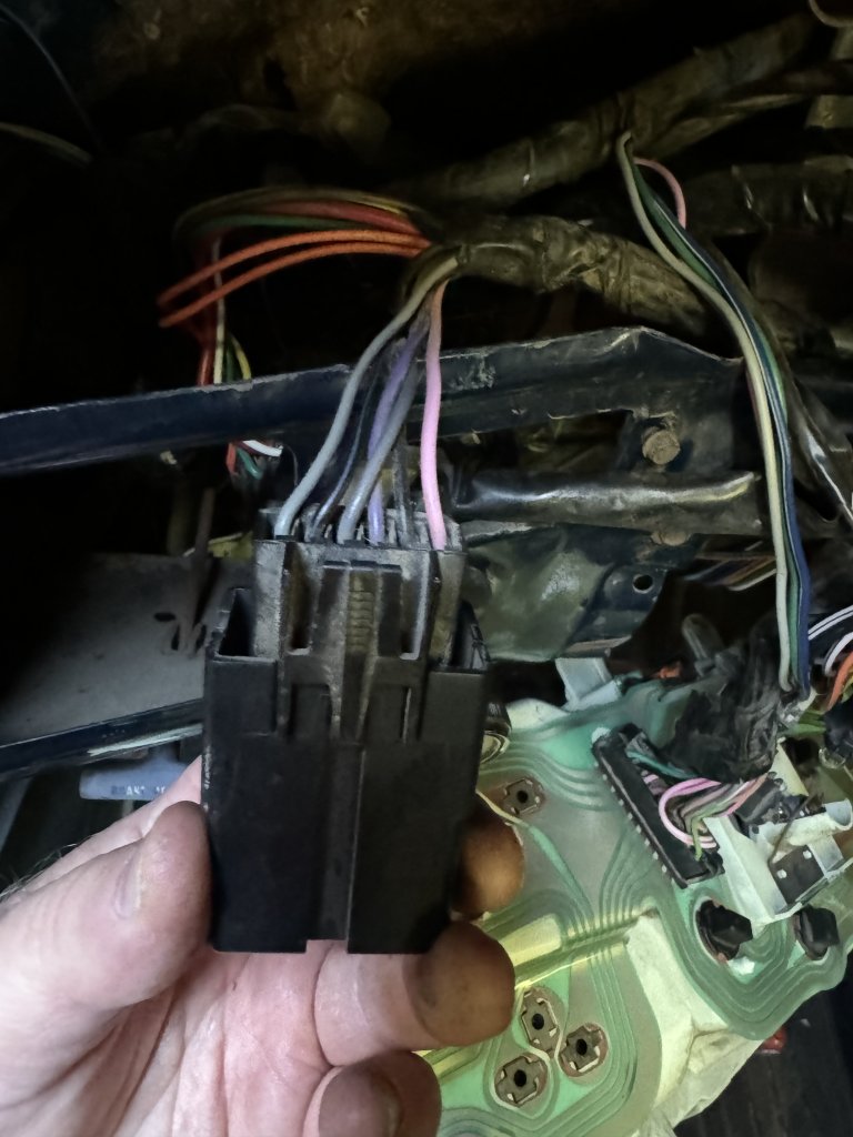

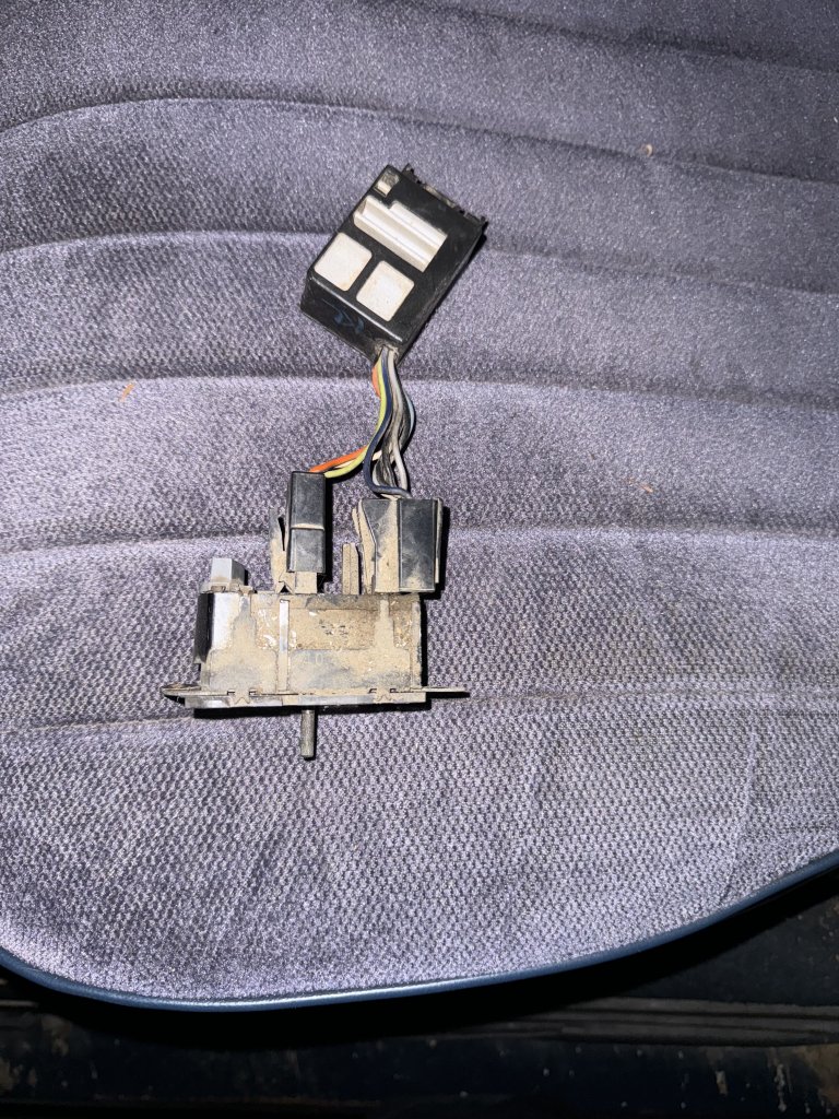

I am working on my 83 gmc k2500 trying to get my wipers to work. I pull the wiper switch out and the switch is not connected to anything in the harness. I don’t see any plugs behind the dash that would plug into the delay module. The only thing I see that would plug into it would be plug that looks like plugs into the coolant sensor from what the part number shows. I’m at a loss from what belongs where. Here are pictures of what I have. Any help would be greatly appreciated

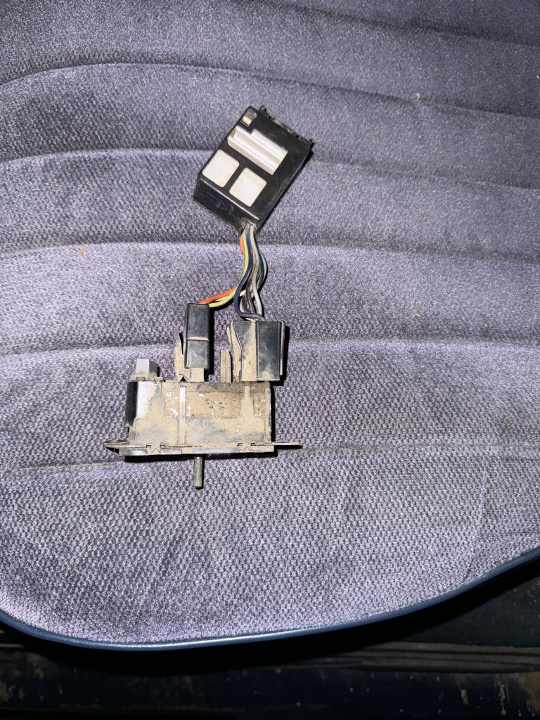

maybe this will help.
W/O CD4 (the pulse module ) Wires go to wiper washer switch- is sort of hard to read.

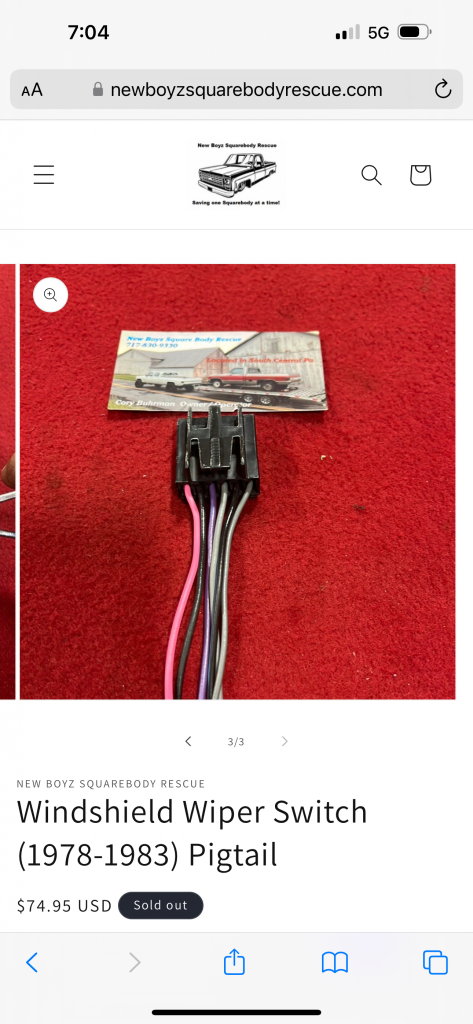

This is what I was looking at. Those colored wires are plugged into the low coolant module which is odd because both the wiper delay and low coolant module both work with the pigtail with those colored wires

I've never dealt with low coolant module, but the wiring diagram (83- diesel) I'm looking at shows different wires.

That’s what I was looking at also but don’t see those wires in the dash. I’m extremely confused over Al this hahaa
