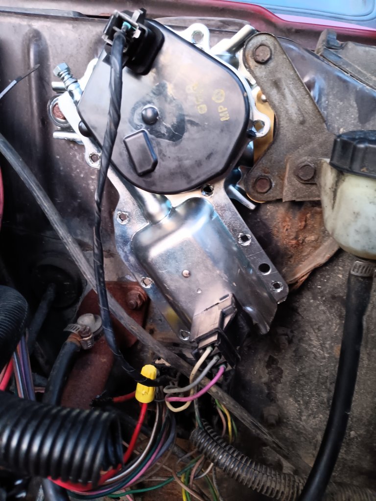

Hey there y'all,
My wipers stopped working recently on my '87. My first guess was that the motor had gone bad; they stopped working one day, then worked for about 10 minutes the next morning before quitting for good. I replaced the motor, no dice. My guess is that I've lost power to the switch (I had the same issue with my headlights, I think the wiring from the starter to the firewall is bad). I've had trouble finding diagrams, does anyone know which wire on the firewall is power to the wiper switch? Thanks.

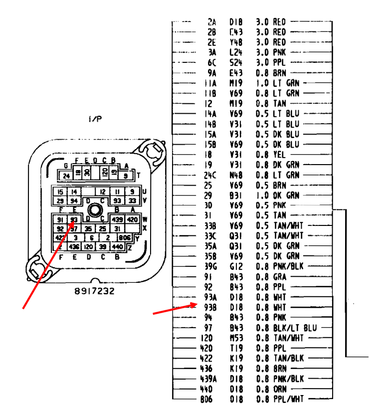

WHT-93 power from fuse box.
WHT-93 supplies current to wiper motor & washer motor. Wipers work by being grounded by one of the other wires by the wiper switch.
The wiper switch itself is grounded by BLK-150 which goes to ground bus on driver side kick panel. It's located behind lower AC vent by e-brake
PNK-94 ground -washer
PPL-92 ground -fast
GRAY-91 ground-slow
BLK/LT BLU-97 grounds GRAY-91 (slow) until park switch opens at end of cycle,
BLK-150 ground

Thank you much! Hopefully I'll get it working tomorrow
