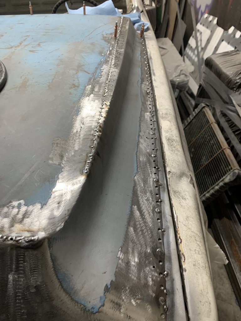

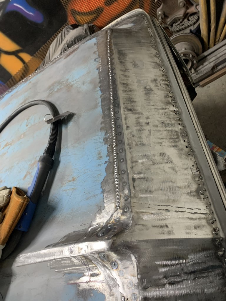

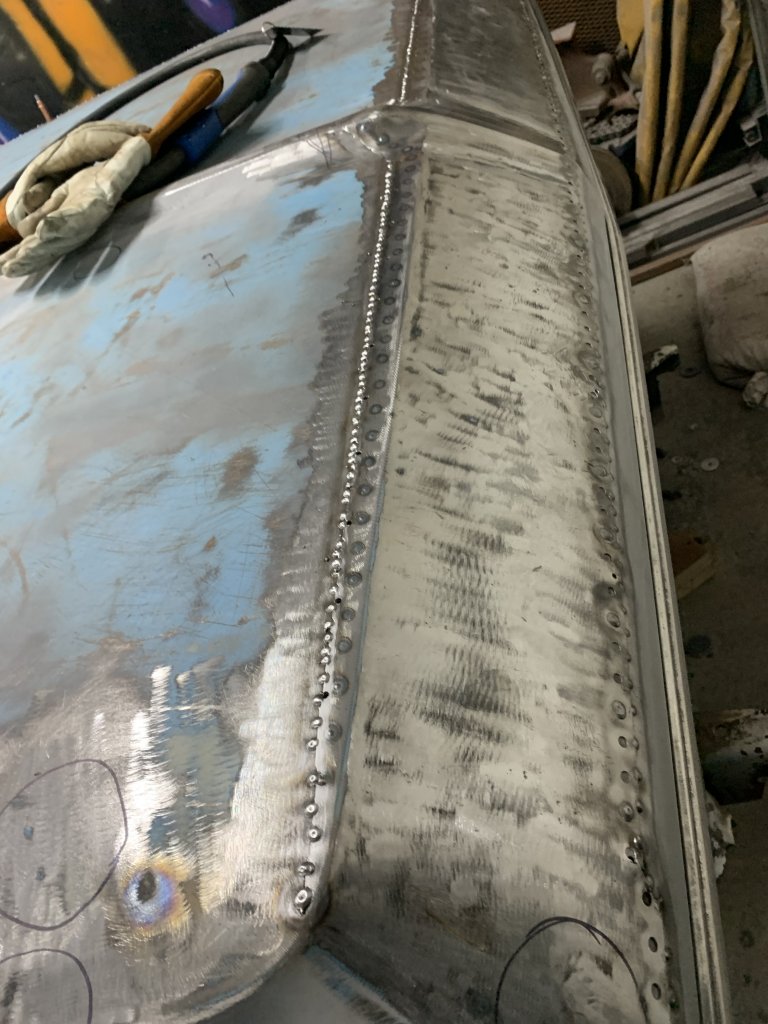

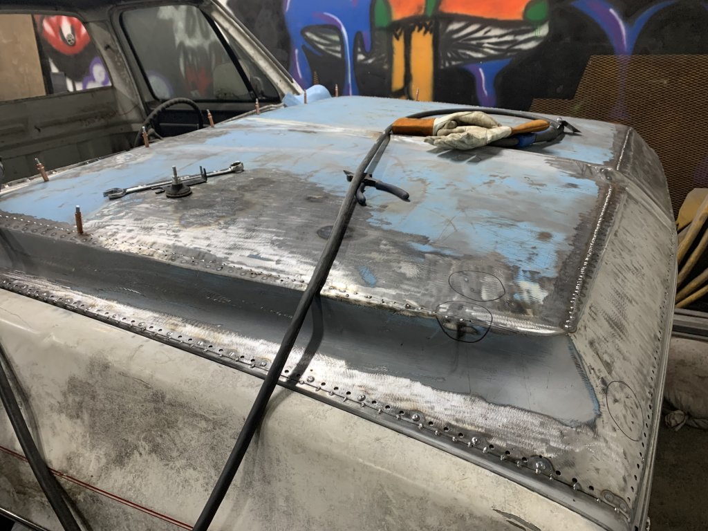

Slowly welding the hood mod together

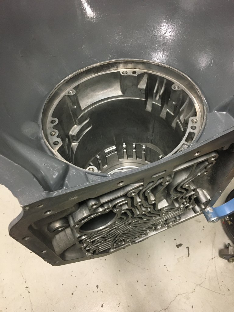

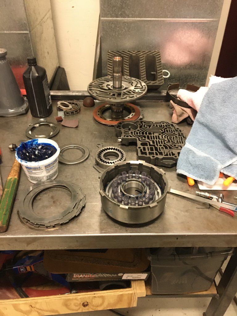

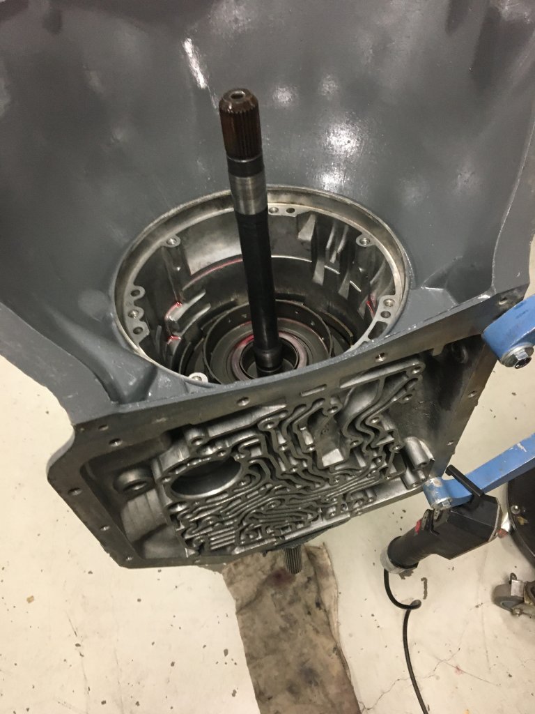

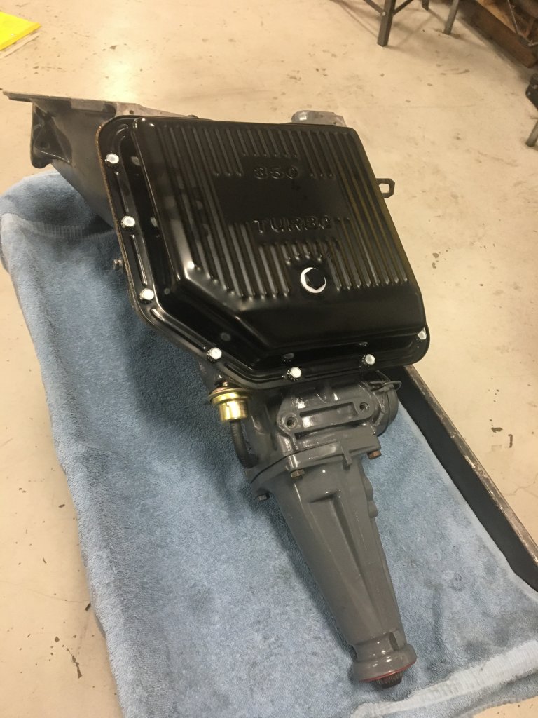

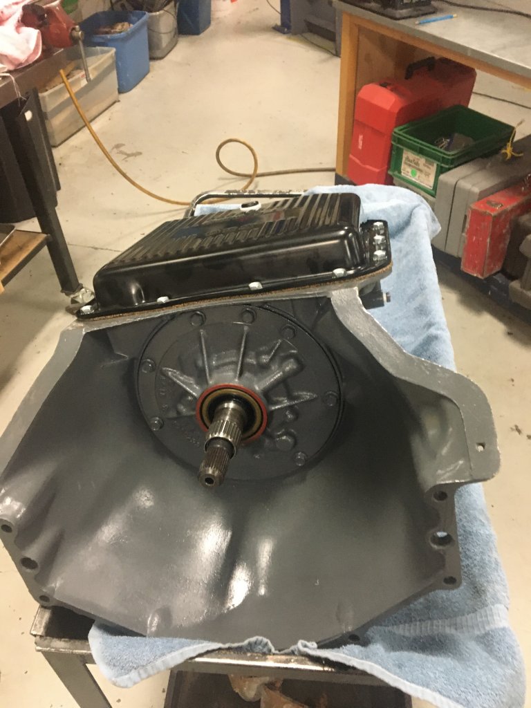

My 81 GMC currently has 207000km or approximately 160000 mile and I would rough estimate 300 passes down the drag strip. It went down the track 50 times this last summer alone. In 1988 it was a track champion in the street class. And the transmission has never been out of the truck, oh it did get a shift kit early in its life but that was just pull the pan. That said I have been wondering when it will start giving problems so I bought a core transmission and rebuilt it and will install it in the spring/summer. Original is a lockup and this new one is standard converter and I am going to install a higher stall converter. Built with red plates and machined to accept 5 friction plates per clutch other than the front clutch. HP sprag race and new sprags. Rebuild kit from Cyclone is real nice to use and installed a Transco 1-2 shift kit.
