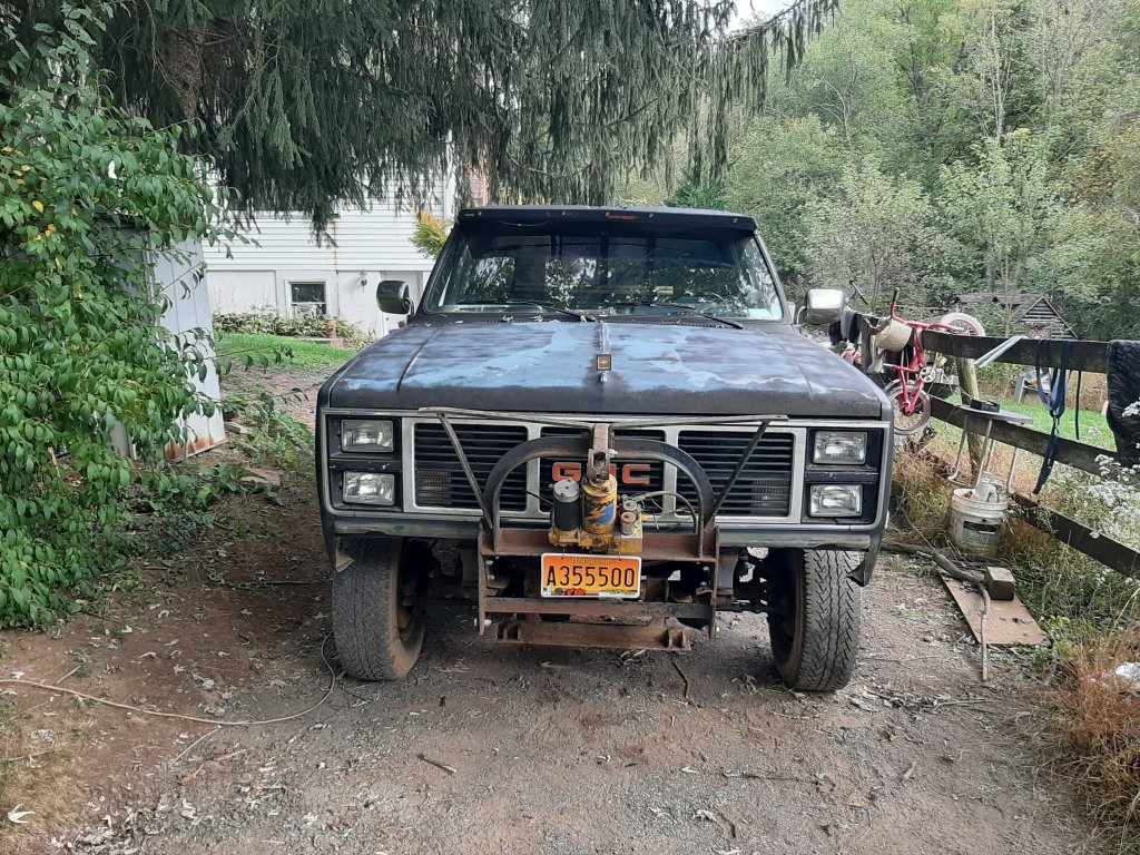

Put a snow plow on. Need to get a couple cable ends for my power wire then pick up my blade at work tomorrow.

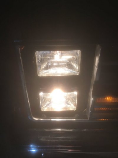

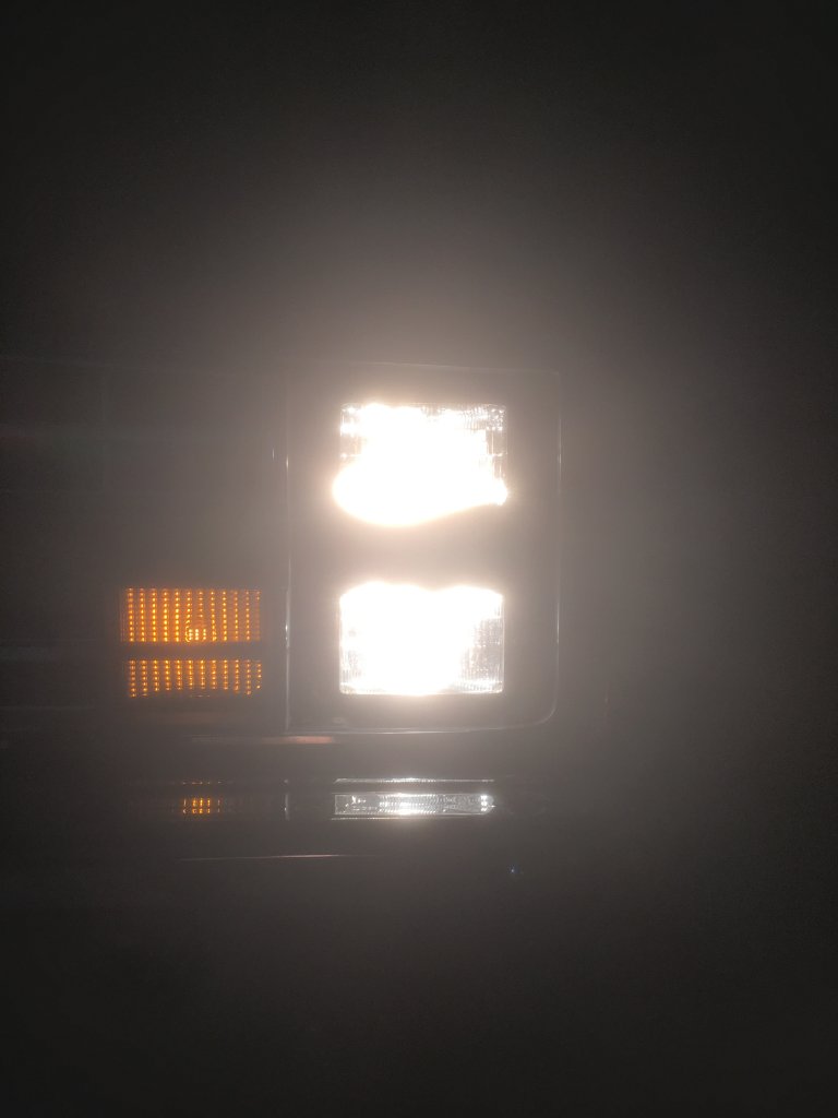

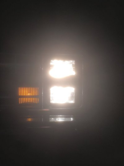

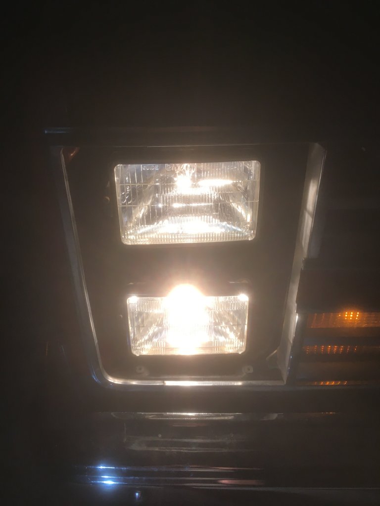

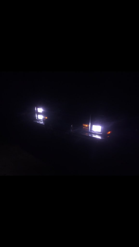

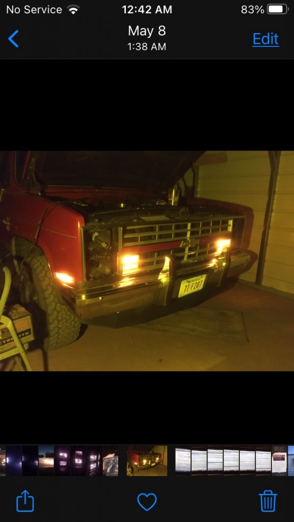

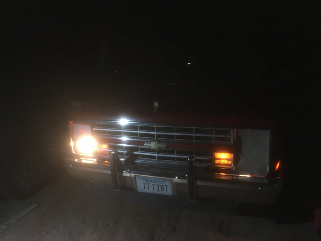

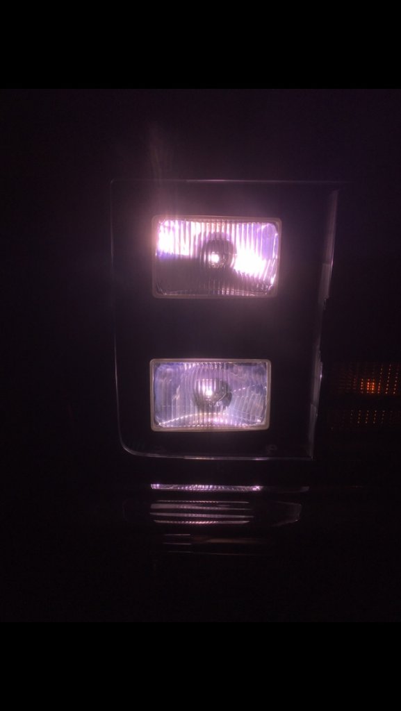

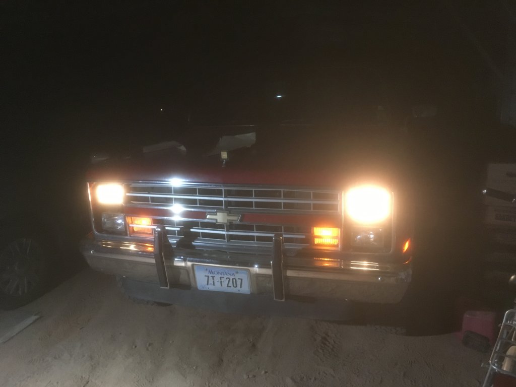

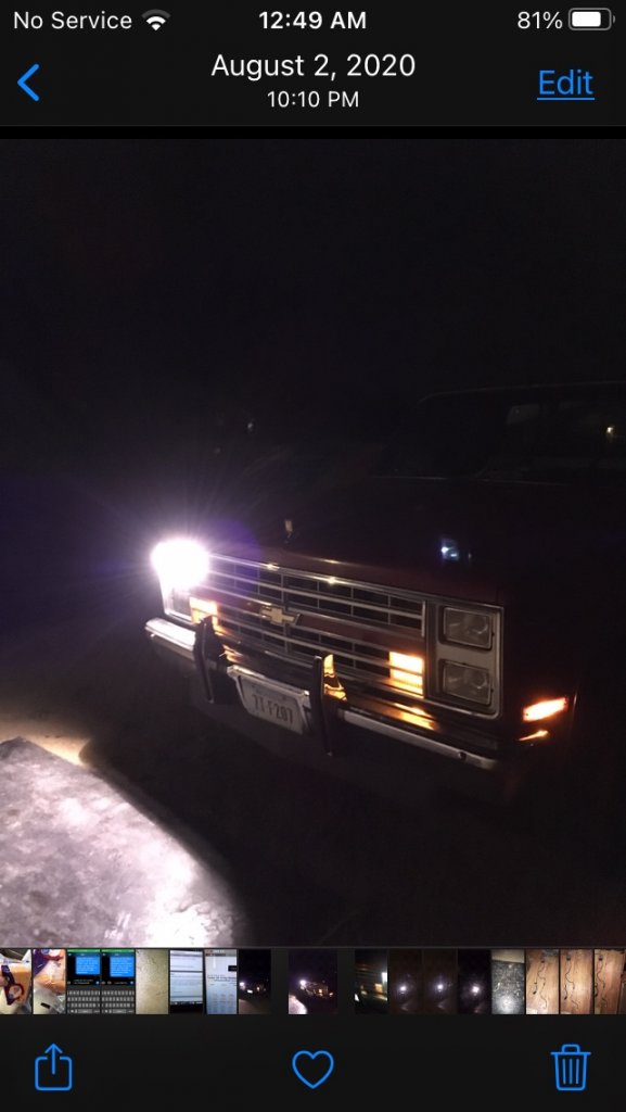

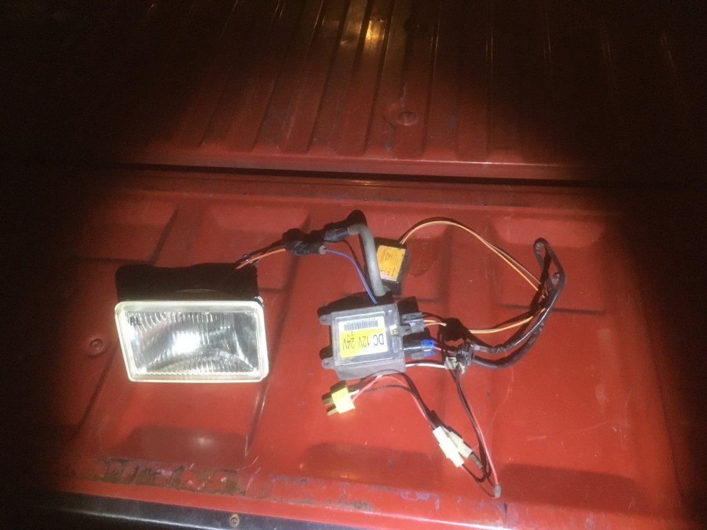

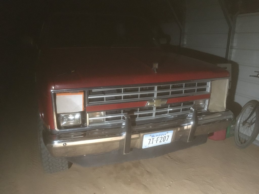

I finally finished up with converting from the HID headlights I installed about 20 years ago, back to plain old sealed beams after one of the HID's burned out last summer... took awhile to line up the sealed beams I wanted, and to remove the mess of ballasts and ignitors, get new adjustors to replace stripped ones, and get everything installed and aimed. Verdict: Not as much light overall, but all of the light goes to the right places instead of spraying treetops and off in the weeds- big improvement! ...plus it looks and feels old school like it should. More pictures in next post...

I covered 3 of the headlights with pieces of pizza box so that I could aim each one independently... apologies for the blur... the lens on my iToaster is full of dust.

Just stock halogens, H6054 Sliverstars I believe.
H6054 is the number for large square headlights... H4656 is the low and H4651 is the high beam for the four headlight trucks. Don't ask me how I can spit up those numbers from memory, haha.
