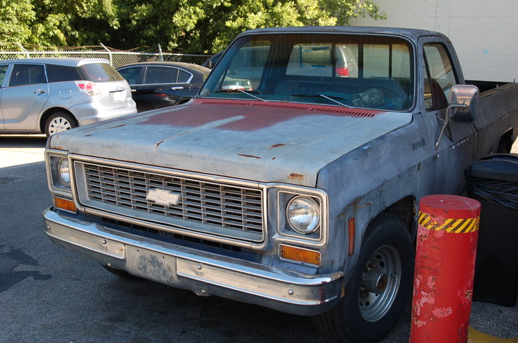

Abby and I took Big Bertha to Hot Rod night at Top Notch Hamburgers. Had a blast. We worked on her for a while this afternoon too, got the turn signals working, need a new carb though, anyone have a 454 Q-jet around that we can use?

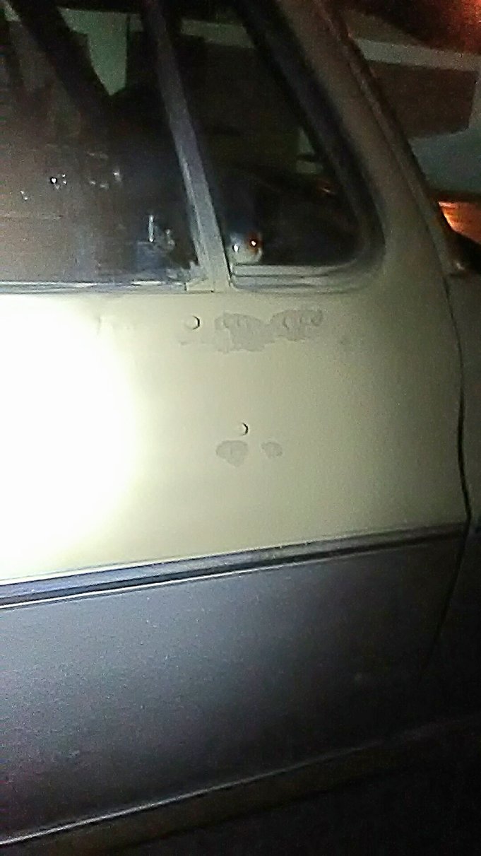

I took the passenger side mirror off, filled the holes with silicone caulking, and spray-painted​ over them.
Ungh. :grd:

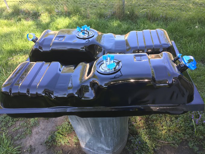

I had extra clear left over so.....lol

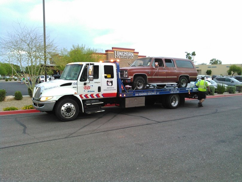

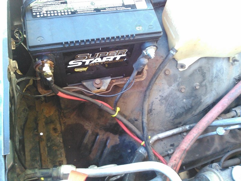

Tried to get the 86 'Burb in shape for a Scout camping trip last weekend, but we didn't get off to a good start. The alternator and battery crapped out just as we were going to the meet-up on Friday night to leave. Had to take the '05 Sunfire up Saturday morning. All told, things could have been a lot worse.
I had just finished replacing all the coolant lines and t-stat, then the radiator because it sprung a pinhole leak once I started getting better pressure. Worst part was, I had a spare alternator and battery ready to go, but the brand new battery was only at 6V, so we had to call AAA rather than me swapping parts in the parking lot.

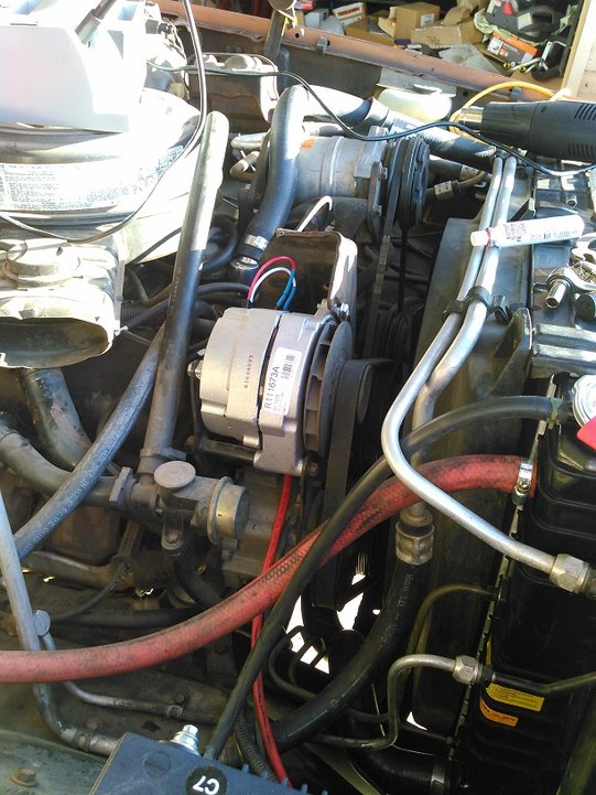

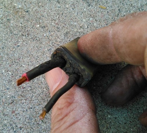

Yesterday I replaced the alternator with a 94A 12si version, built a 6 gauge charge cable from the alt to the battery, cleaned the grounds and the remaining battery cable ends, and everything seems to be running smooth. I'm not sure if the smoked connector in the pic is cause or effect. I did hear some good bearing noise from the old alternator before things went south, so I'm guessing the bearings fried and the resulting heat cooked the connector and wires.
Hopefully I will be able to take it on the next campout coming up next weekend.
Still to come: more sorting of the wire harness to get the dual battery setup back up to spec, a tune-up and emissions test, then hopefully fixing the AC and installing my Air / Fuel ratio gauge.
