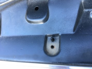

View of the harness rosebud clip where I use the second of two holes already present in the core support. The other hole secures the grill.

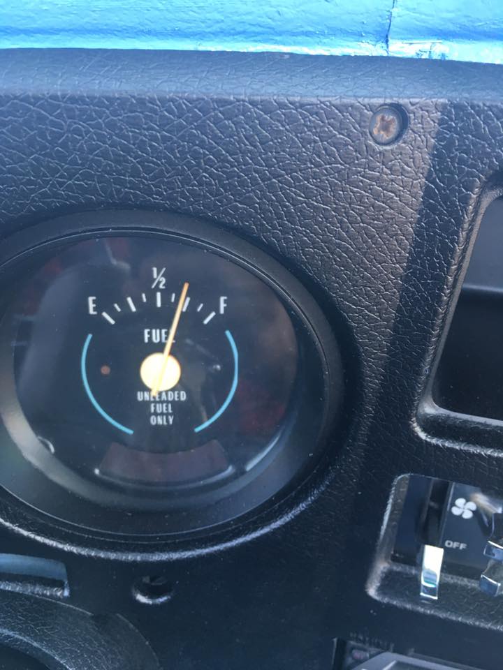

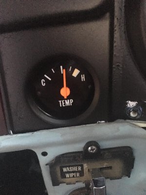

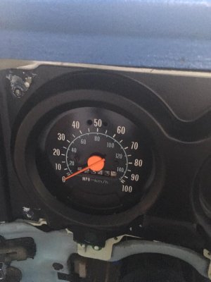

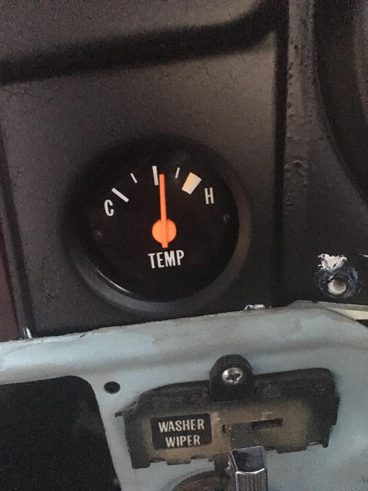

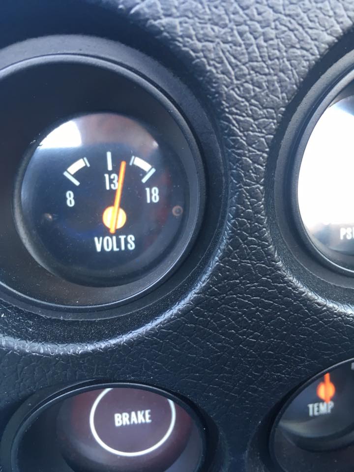

A little fluorescent touch up.
Very nice work on that harness, good sir! Someday when I have some cash floating around, I need to see if you can whip up a crewcab, relayed, express down window harness. :D

Very nice... What did you use?
I bought a can of fluorescent spray paint at Walmart for under $4. I pulled all the gauges except the oil gauge. I took sheets of copy paper and cut a slit into them about 1/2 way. I slid the paper under each needle and taped the slit closed. I then sprayed each until completely coated. To do the oil gauge I sprayed a piece of paper until I had enough to dip a small paint brush in and then painted it by hand. The difference in the gauges is like night and day now. My wife got a little mad when she saw them, because she thought I'd gone out and bought all new gauges! :shrug:
