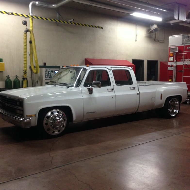

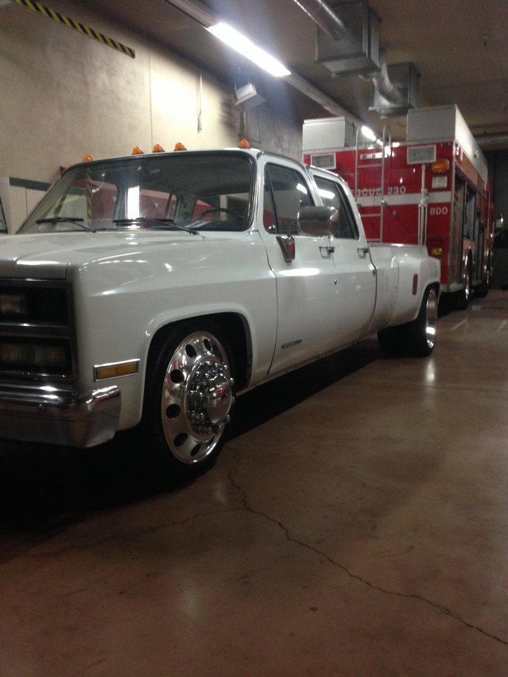

C30 Dually 3+3
Got it 3 months ago and have been very busy
5/6 drop ( 3" spindles, 2" springs. 4" shackles, 4" hangers, removed leafs)
22.5 wheels and tires
alignment
pinion angle is dialed in
short headers, dual magna flows
full stereo system
fixed high idle problem got aux fuel tank working, fixed cruise control, relocated and replaced 7 pin trailer harness, found a like new original tailgate, throttle cable replacement,
new windshield
gear swap 4.10's to Yukon 3.54s.
Tachometer/fuel gauge combo installed
I still have a lot of things to do, but the big ones are out of the way and I can drive and tow with this thing anywhere.
