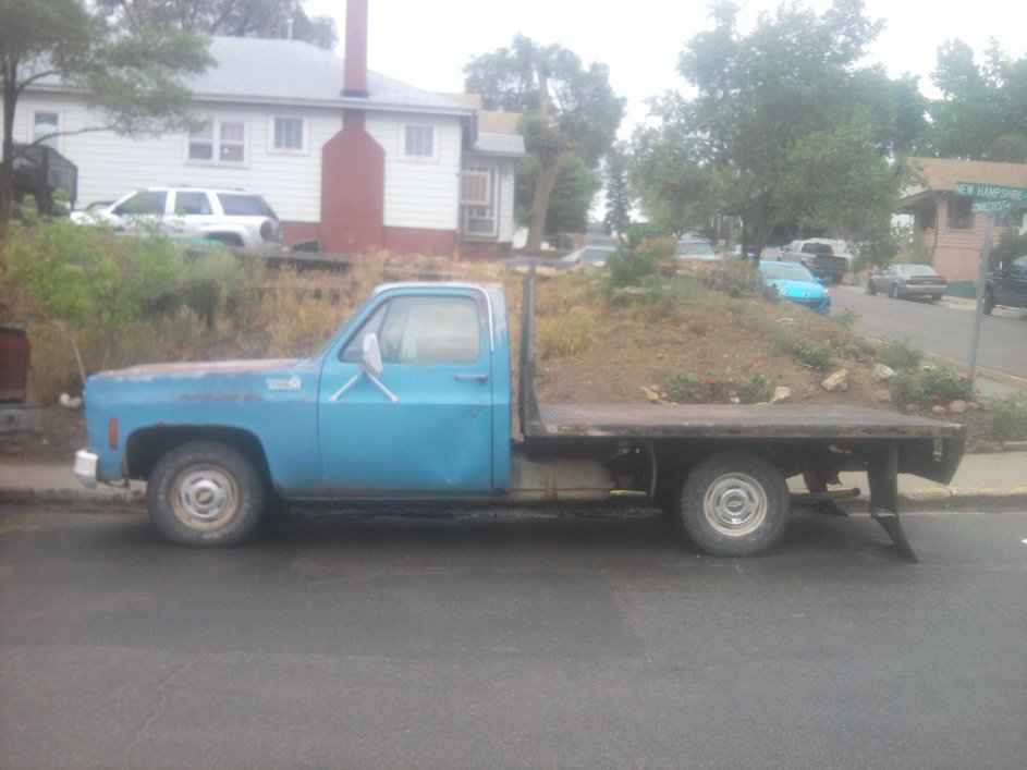

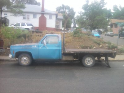

I put a flatbed on my 78 c10
the bed was side swiped on both side and cratered in.
I picked up this flat bed and figured it would be a nice home for it and make the truck a lot more useful I just use it to haul stuff and as a beater truck
I also came up with a name for the truck after putting the bed on cowboy since it looks like a cowboy truck now

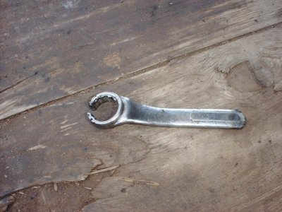

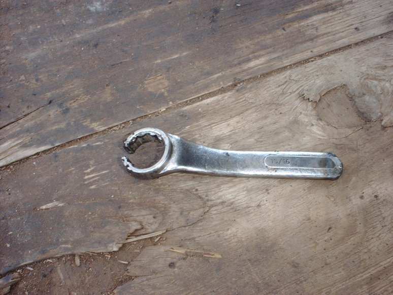

I sacrificed an S-K wrench that has been in my tool box for years and has never been used on anything.
I was able to remove the large nut to get the brake line fitting loose.
The wrench worked perfectly when nothing else would.
