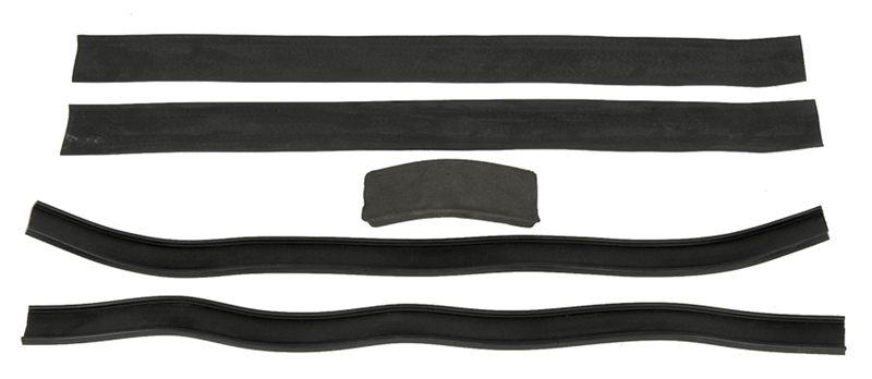

Anti squeak? I’m sure it’s only like $20 but any host of materials can be substituted for free depending what you, your neighbor or buddy have laying around. I cut strips of ice n water shield leftover from roofing the house. But rubber strips like an inner tube or tar paper, sound deadening sheets, even a piece of thin plastic like cutting up one of the kids old plastic sleds.
Just an example of how to save a buck. And every buck you save is two you can justifiably spend on a tool to make this project or the next one easier!
Just an example of how to save a buck. And every buck you save is one you can justifiably spend on a tool to make this project or the next one easier.
I am brainstorming on a material to use instead of an "anti squeak kit" that cost $30. Probably going to try and source some tar paper from my father in law.
If you want to PM me your address, I can mail you strips of EPDM rubber roofing membrane. Works like a charm and should last longer than most anything else. It’s what I used. Cuts with a utility knife; just use a piece of scrap lumber or a framing square for a straight edge.

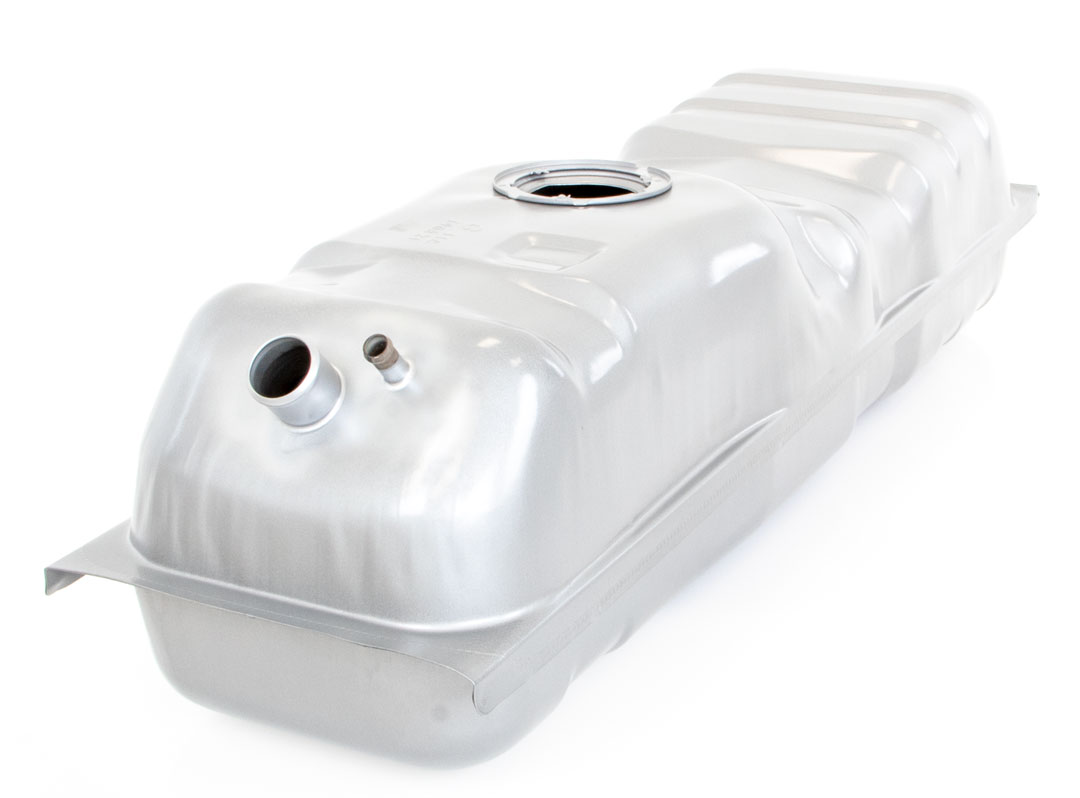

@TotalyHucked Zach, do you recommend AMD brackets, straps, and anti squeak kits? I want to support our passion through the community. It looks like AMD has all the remaining peices to my puzzle. Give me some insight.
Sure thing. So our tanks are $90/ea, we offer both sides and have the fuel injection "basket" in the bottom to keep fuel around the pickup just like the OE. I've got one in my truck and they're super nice, I can tell you.

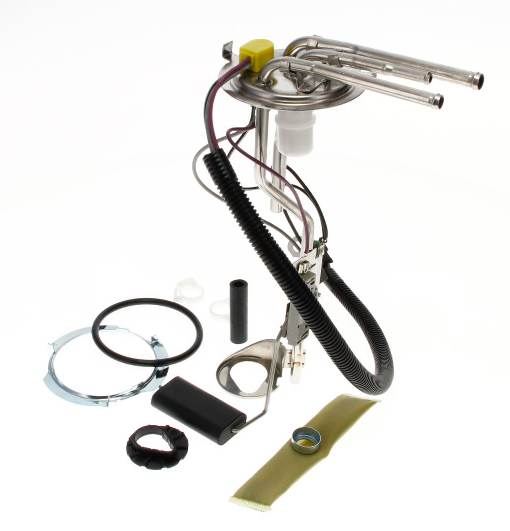

We also have both sides for the sending units @ $80/ea. That has everything you need other than the pump (we don't sell pumps).

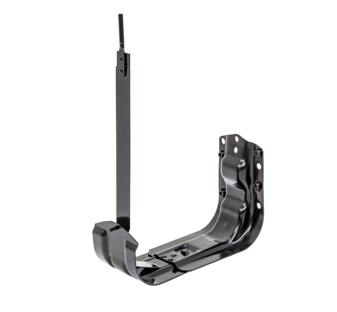

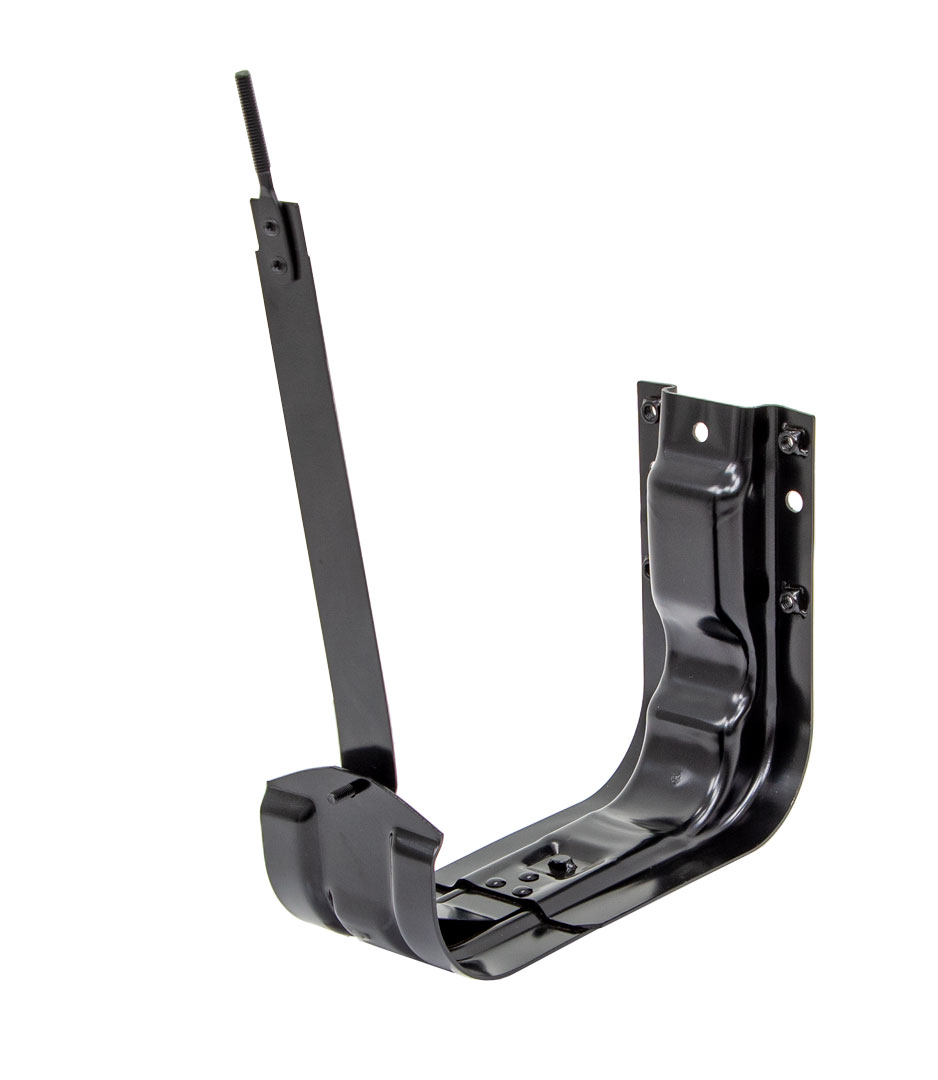

The brackets are $55/ea (you need 4 obviously) and are very nice pieces.
And the anti squeak kit for $28
All of these are very nice pieces, reverse engineered off originals so they match everything the OE has. All that said though, I also agree with @Grit dog about reusing most of your stuff. Your straps, unless they're rusted or broken, I'd just wire wheel and repaint. I'd likely reuse the tanks as well as long as they're not rusty or really nasty inside (which you won't know that till you get them down, but since you've been driving this thing with no problem until recently, I HIGHLY doubt you need new tanks). Senders wouldn't be a bad idea, if they're original, they may be cruddy but again I'd probably wait to inspect what's there. The only thing I would go ahead and buy if I were in your shoes is new pumps and new anti-squeak rubbers. And all of this stuff ships via FedEx Ground, we're pretty dang quick at getting that out the door so you being in VA, you'd have it in 2-4 days typically.
