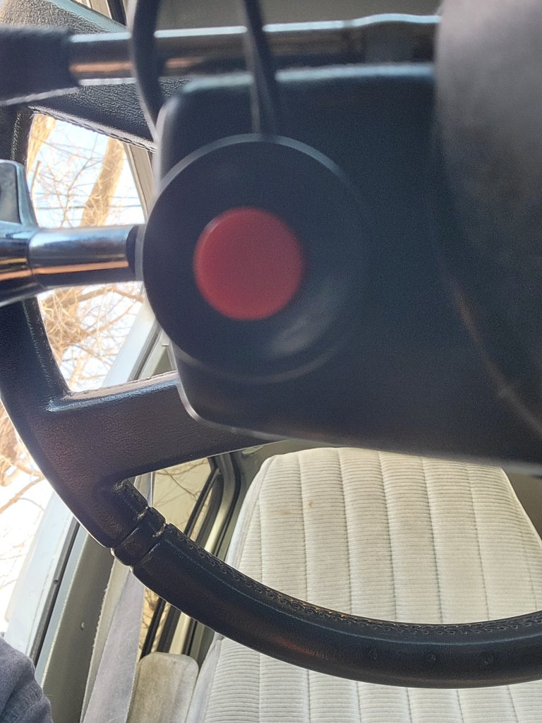

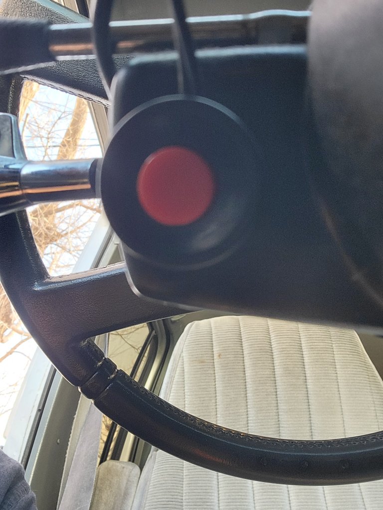

my wiper switch has a loose connection so that when it is less than about 50deg, the washer doesn't work. as soon as the switch gets warm from running the heater for a while, the washer works.
as a work around, and to prevent tearing into the column for a relatively minor inconvenience, I added a momentary switch between the pink and black wires in the harness upstream of the delay module. this grounds the washer same as if the switch was working. the beauty of tapping upstream of the module is that the wipers sweep just like if the switch was used also.
I put the switch on the backside of the column behind the multifunction switch. so it is hidden from view, to at least make it a little less janky

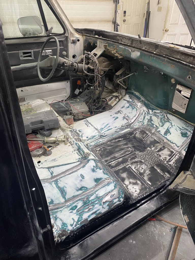

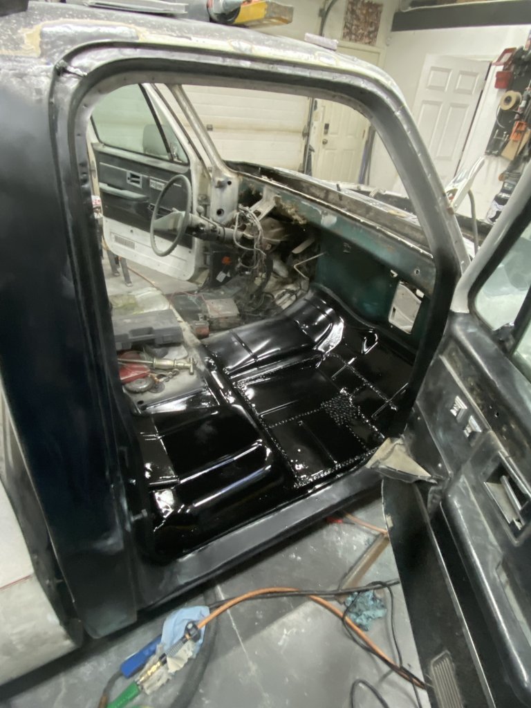

It definitely is, and it’s difficult to not get caught up in the thought processes behind each point On the project, even more difficult to keep momentum when the family gets busy/ work life events.

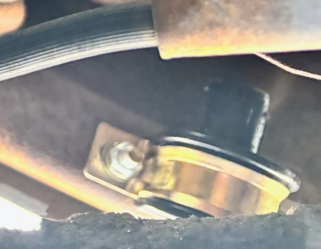

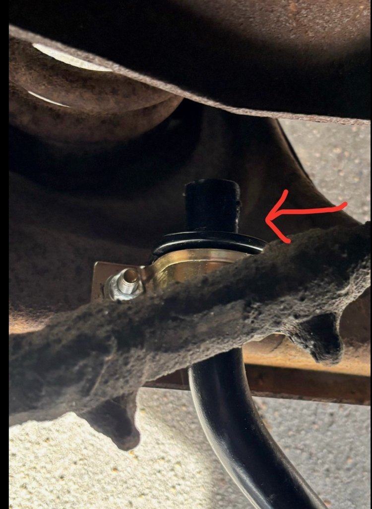

I installed a factory front way bar setup on my 83 GMC, it is the RPO F59 that mine never had. 1 1/16 inch bar. I used the factory bar and brackets with new Energy Suspension bushing 3.5175G and new grade 8 bolts. It seemed to go on easily and lined up with the factory holes in the frame.
But the question I have, I read online that the end of the bar should be flush with the bushing on the A-arm. On mine the bar is sticking out about 1.5 inches, and the bushing seems more distorted in shape that I would have expected. Did I do something wrong? I watched a lot of videos on youtube, and it looks like i have the brackets facing the correct direction, and looks like the bar isn't upside down.
UPDATE: Could it be upside down?

Mine's like that. As long as your bar goes downward toward the control arms, you're fine. I replaced the bushings on mine 60k+ miles ago
**edit** Well, I should say would've gone downward from the factory lol. Looking at my picture, I could probably stand to flip my bar over
