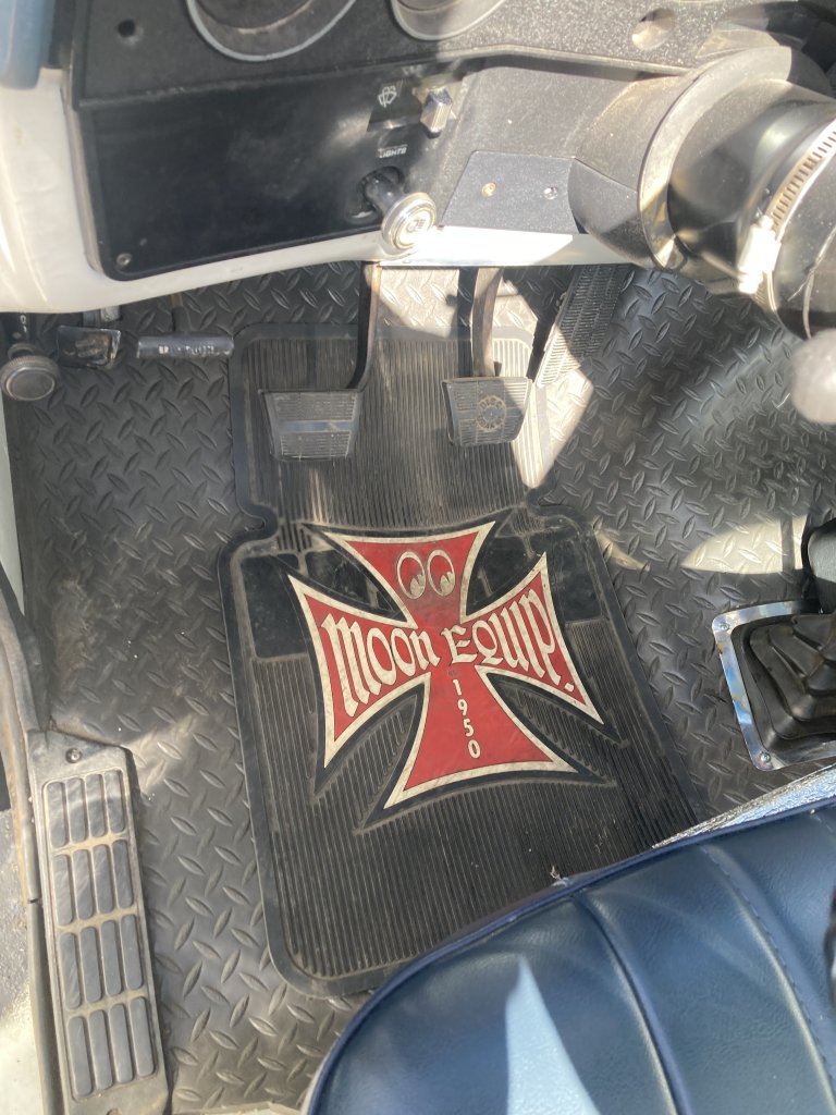

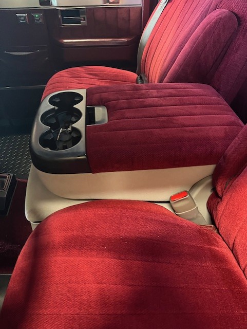

Today I picked up and installed my re-ulphostered seat. Not perfect but a darn sight better as there is no big ole burn hole anymore! Also replaced the glove box plastic as the hinge finally gave out.
With this done my list of Squarebody projects is done! Time to drive and enjoy and take to Cruise In’s and maybe a show.
I really like the steering wheel. I have the same little console and drink holder. It's even the same color. They are a nice piece.

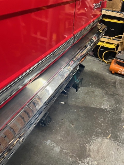

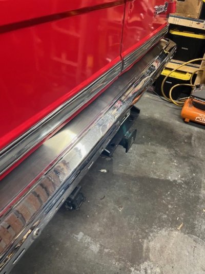

I added a stainless steel filler panel between the bumper and the back of my Burb. The old plastic piece was warped and looked like crap. I do not have a before pic but it is basically a replica of the plastic piece made out of 14 gauge brushed SS. I added close foam weather stripping between the body and the SS to help eliminate vibration noise or scratching.

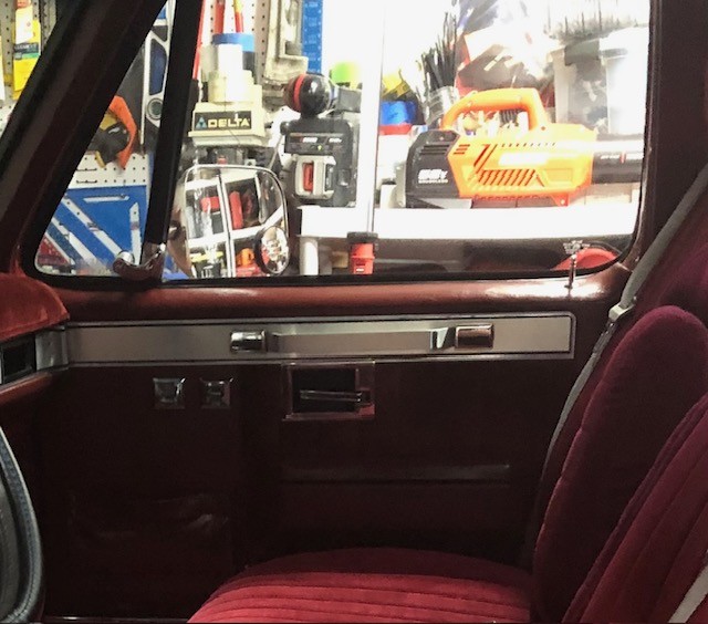

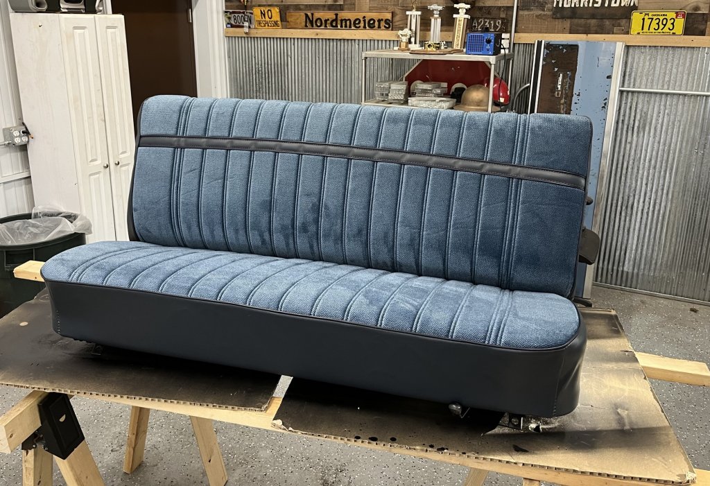

a couple years ago I upholstered and added fully electric seats from a Yukon (with integrated seat belts). The Yukon console was crap so I added a Chrysler mini van console at the time. I wanted to fully fill the space with something better so I just finished installing a bench seat with upper and lower consoles from a newer Silverado. I didn't have enough of the seat fabric so I just upholstered the top to blend it in.
Not sure If I posted this little add-on before or not. I remove the strap door pulls (always hated those) and bent some 1'' aluminum flat bar to make new solid door pulls. I brushed it to look like the insert and coated with several coats of clear to keep the black residue (oxcide) from getting on my hands when used. They also make great arm rest while driving with the window down. The original chrome end caps fit perfectly as well.
Next I think I will find a shop with CNC machine that can make me the lower door arm rest pads out of aluminum. I have always hated the the vinyl padded ones. If I had wood grain inserts I would probably make my own wood ones.

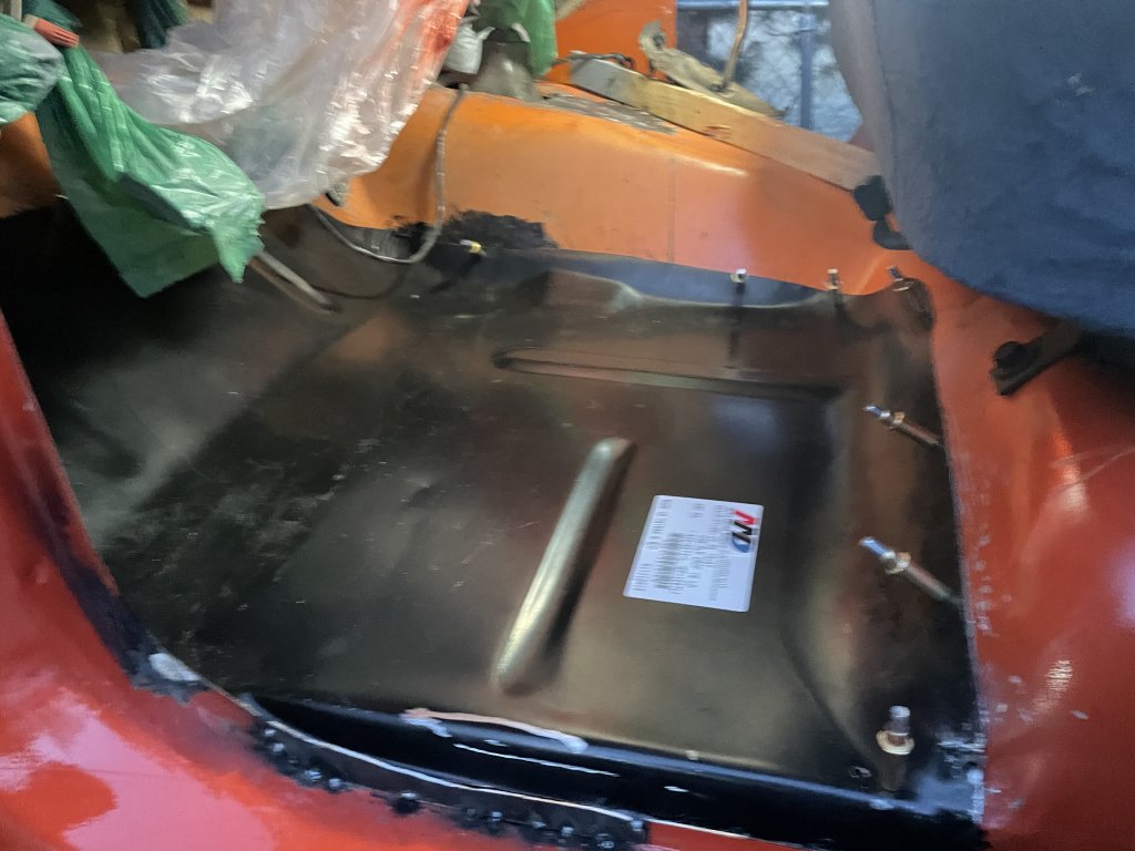

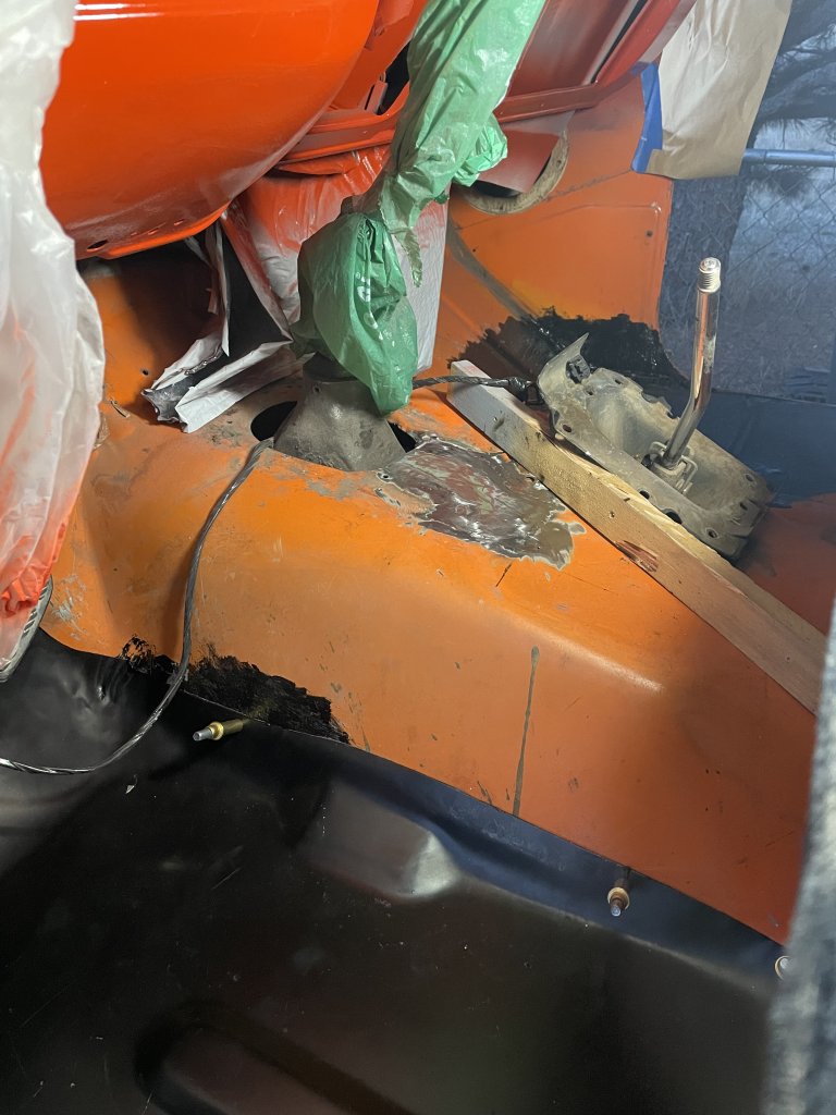

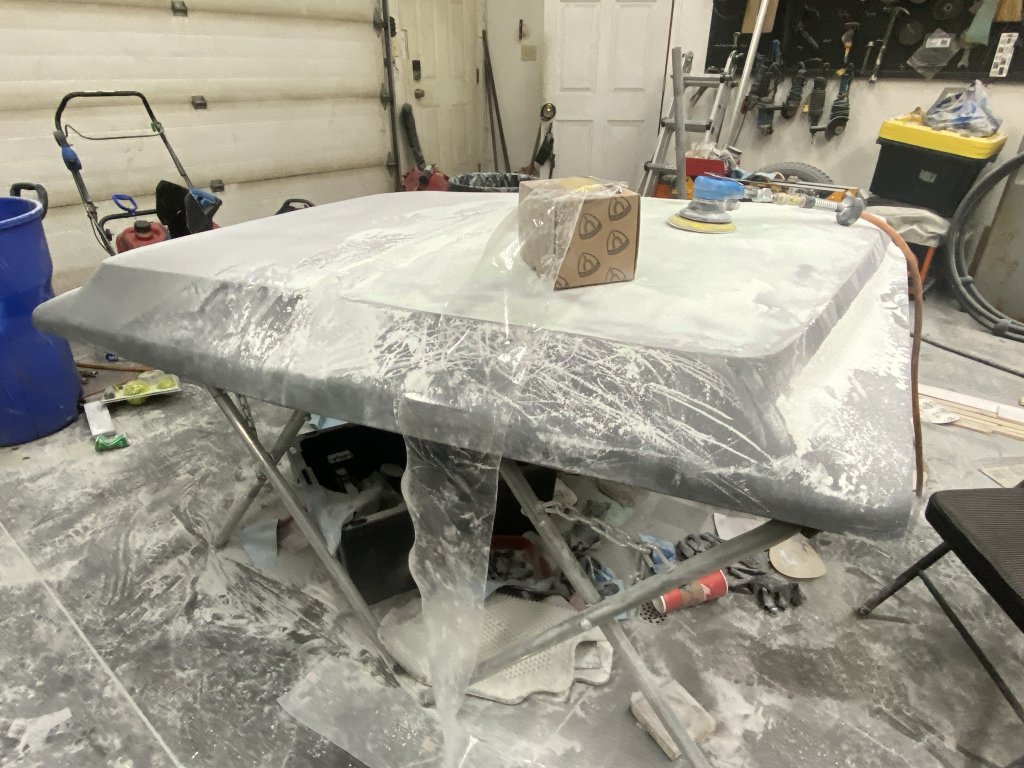

PO cut a hole on the hump and then put a piece of rubber over it so I fixed it right with a wire feed metal patch. Making some progress on the rest of the floor, hopefully soon I will be to put the doors back on.
