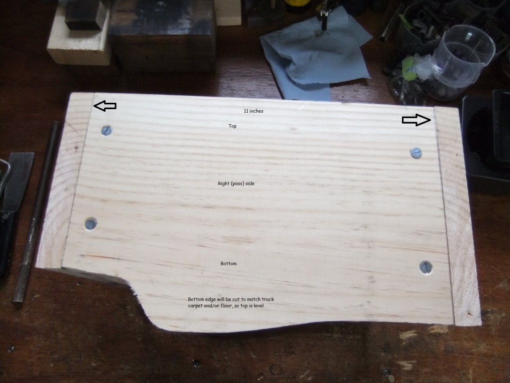

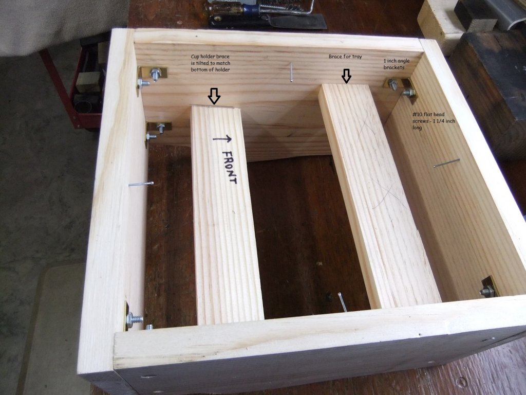

By special request.......
Here's some info on my cupholder.
Measurements are on the pieces.
I used a 1 x 10 pine board to cut the parts from.
The above piece is the same for the left side.
You will need to figure out the bottom of the unit to match a particular floor/carpet design.
(My seat end piece is 5" high and the front end piece is " high. Yours could vary depending on the floor arrangement)
I have a 2 WD truck. I used a piece of cardboard to make a templet to get the top kinda level.
The braces for the cup holder and tray were measured and formed with the unit upside down if that helps.
The cup holder is somewhat tilted on the bottom, so that brace is at an angle to support it.
I will a screw thru the bottom of each to hold them to the braces.
Ask if you have questions......... or if I left something out.

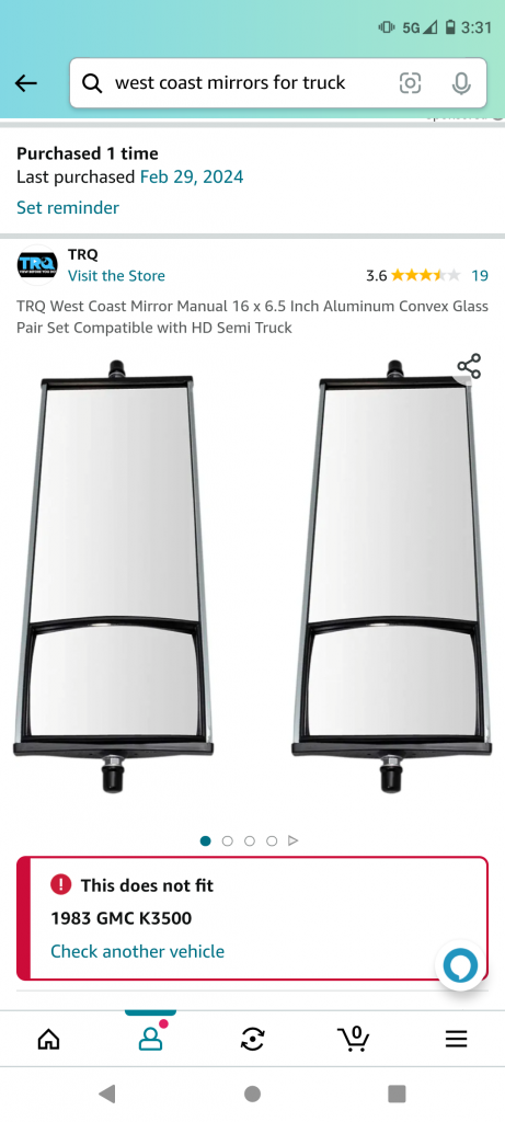

Went ahead and ordered some new mirrors it will be nice to actually see in them lol
