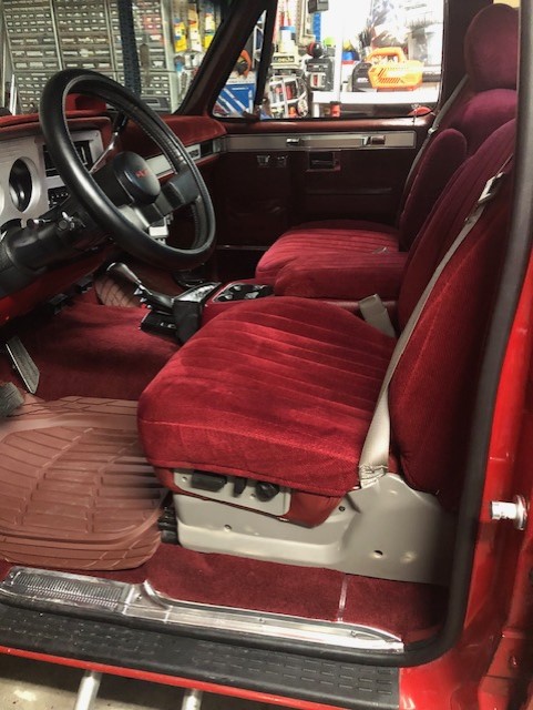

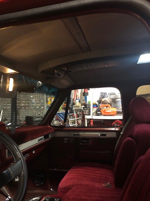

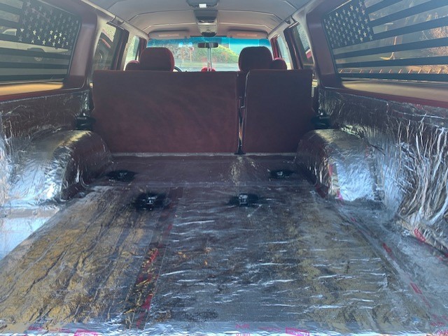

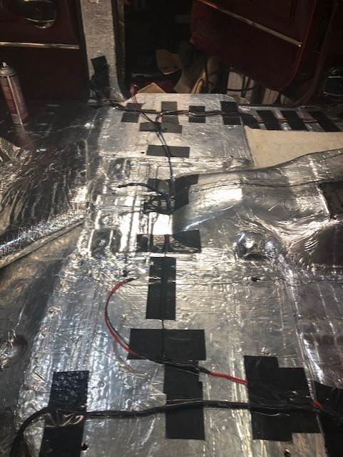

Here a but a few of the "custom" items I have done on my 87 burb. I made new door pulls from aluminum flat bar and reused the chrome covers, cleaned up a steering wheel from a 94 Jimmy and installed, modified an overhead console from a 2001 Astro van to fit and also replaced the old bench seat with fully automated seats from a 2007 Yukon. The seats took some floor pan and support modifications as well as adding new electrical fuse box for new center console and seat electrical.

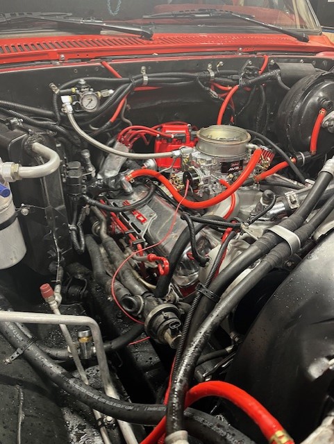

Here is my current "mod". After many years of running squarebodies, I have always preferred card vs. TBI. My 87 GMC Sierra Classic is TBI and I am in the process of swapping it out to carb. This is not my first one I swapped and it is time consuming. The bad thing is that I rebuilt my motor last year with TBI but soon realized that I wanted to go carb. Anyone doing this, I would recommend not to hack out the TBI harness or connectors. I have mine sealed up in header wrap and tucked away. Here is a pic of my motor I rebuilt with the TBI last year and a couple pics of the same motor in the truck last weekend after I did the TBI to carb swap. Disregard some of the incorrect vacuum lines, that my older son thinking he was helping me out.:)
