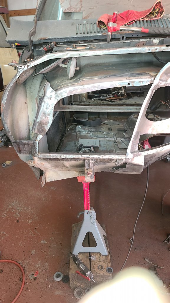

Over the weekend I got the firewall upper seam resealed. The engine bay cleaned, coated with rust killer, cleaned again, painted with multiple coats of rust encapsulating paint. Got the 87 fuel tank painted, the stock brackets painted as well. the LS fuel pump (Wallbro 350) added to the tank and lines ran to the engine bay. Also pulled the heater core and replaced that while cleaning out the rat nests. Oh and I got the donor 2003 Yukons lower radiator core support cut out and mocked up in the C-10 so I can use the stock LS radiator.
Hopefully get the engine prepped this weekend and possibly get it set in place but that's going to be pressing it with as hot as its going to be.

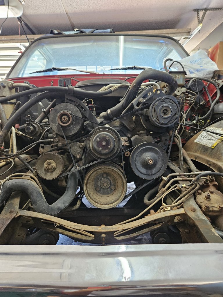

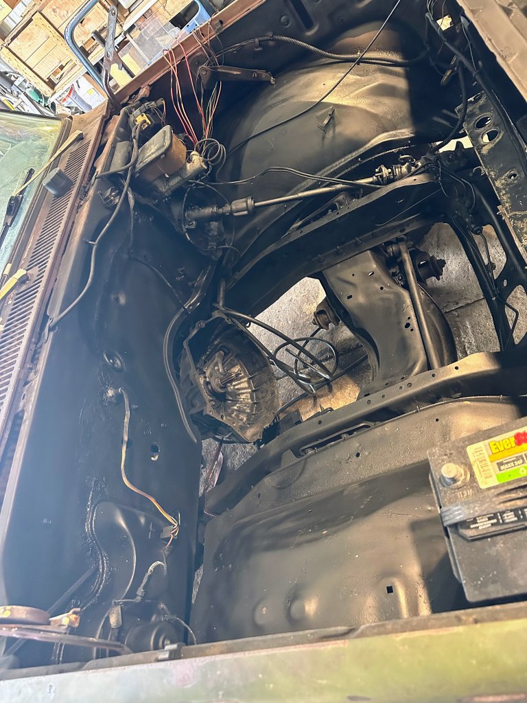

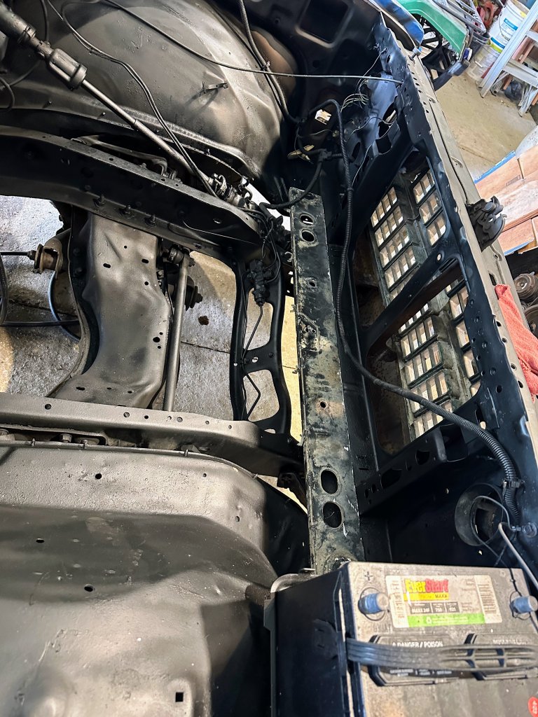

Getting ready for engine pull!!

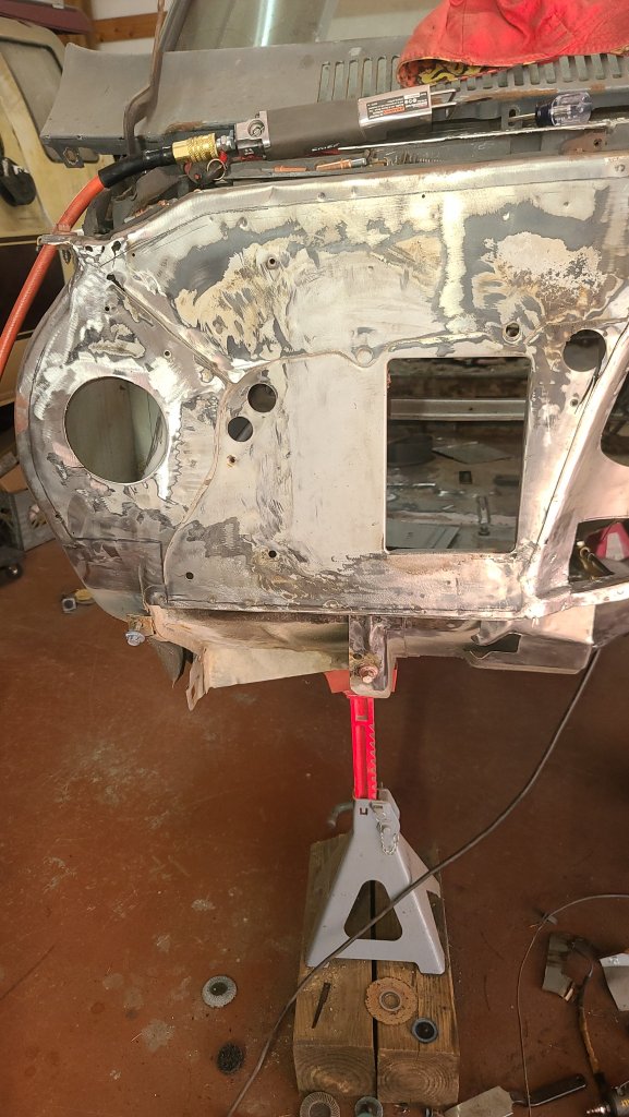

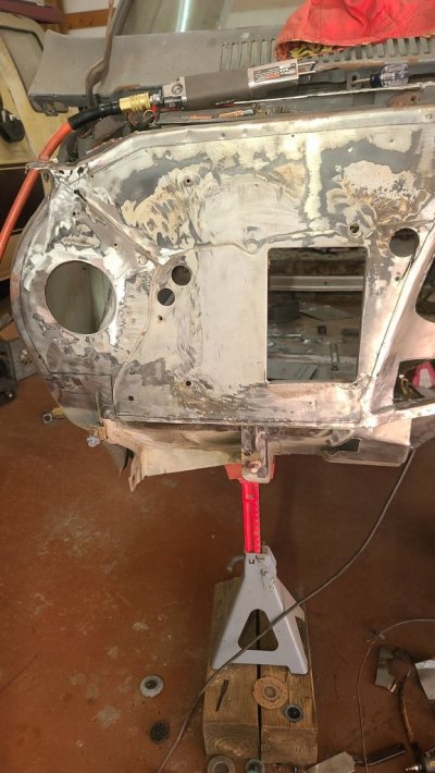

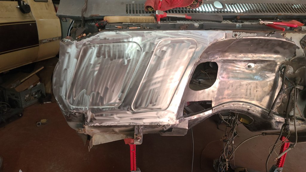

Shaved the firewall today. I still have to finish welding, but I'm very happy with how it looks.

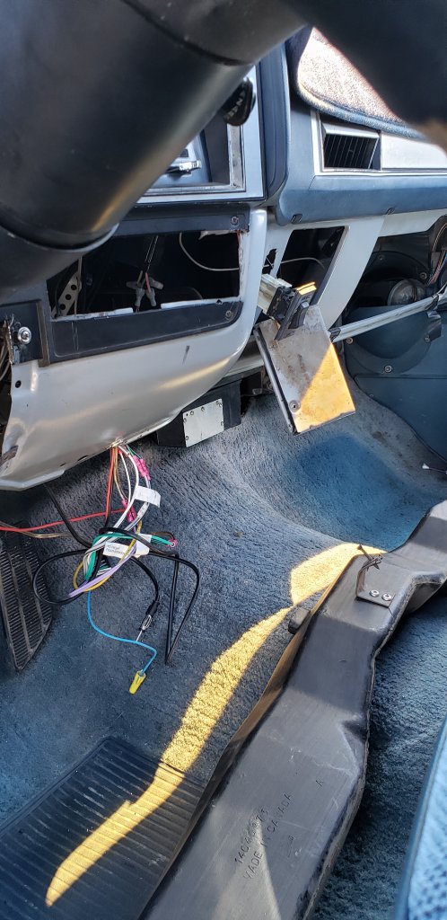

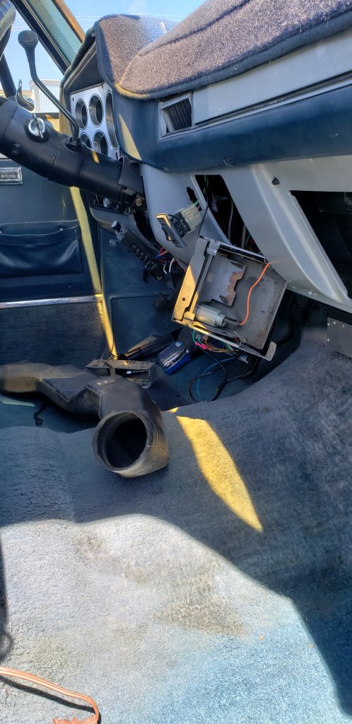

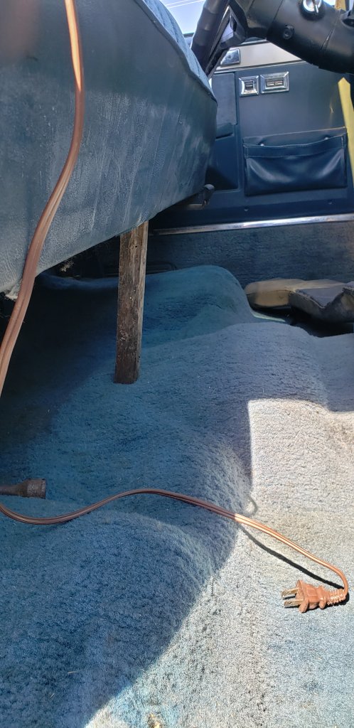

Smokey's been sitting in a field for over a year now, we go start it up regularly and a couple of weeks ago the manager of the park we live in said I could bring it over to clean/wax and do some minor maintenance. As soon as I got it here the radiator started leaking. I took it back to the field, replaced the radiator and hoses and brought it back. So far 6 mouse nests and a smelly cab. No major damage yet, wires/hoses are ok. I've removed the seat and I'm gonna vacuum and shampoo the carpet and seat, take out the glove box/ash tray and see if anything is happening under the dash then put it back together and drive it in Ramona Cruise Nite with my darlin' wife Beth and a POW and American Flag in the bed. Good times!
Chasing nests,,, I think I have them all, now to scrub/sanitize put it all back together and drive for a bit. I do have to reconnect the heater control cable to the flapper but easily done now.
