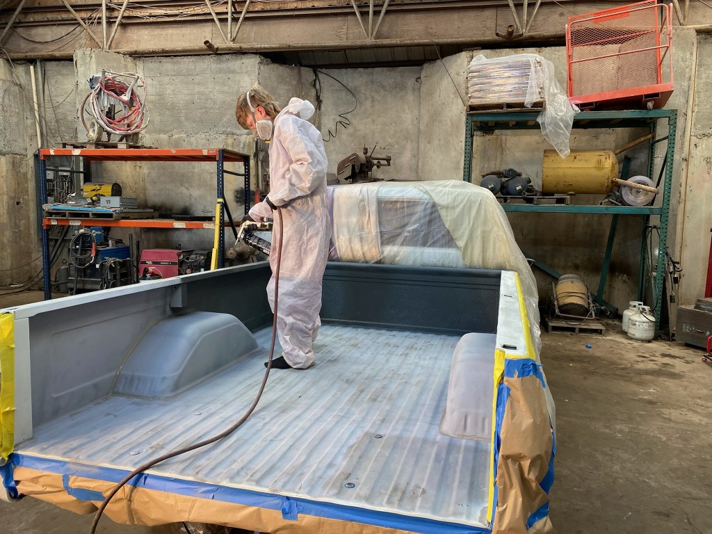

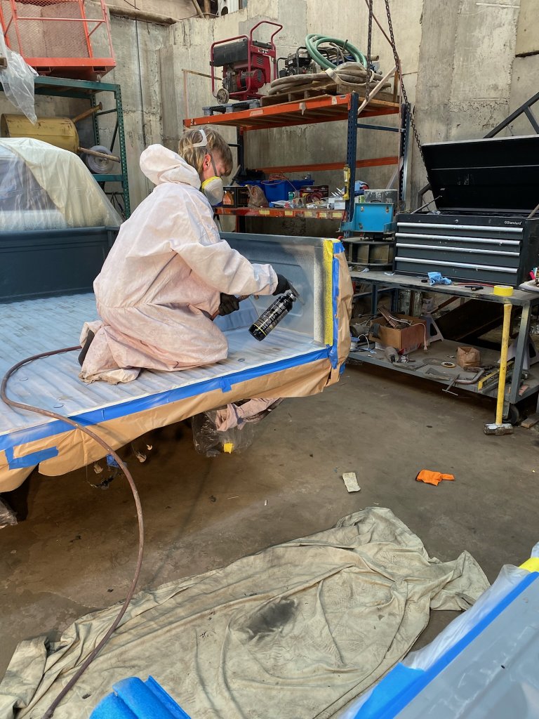

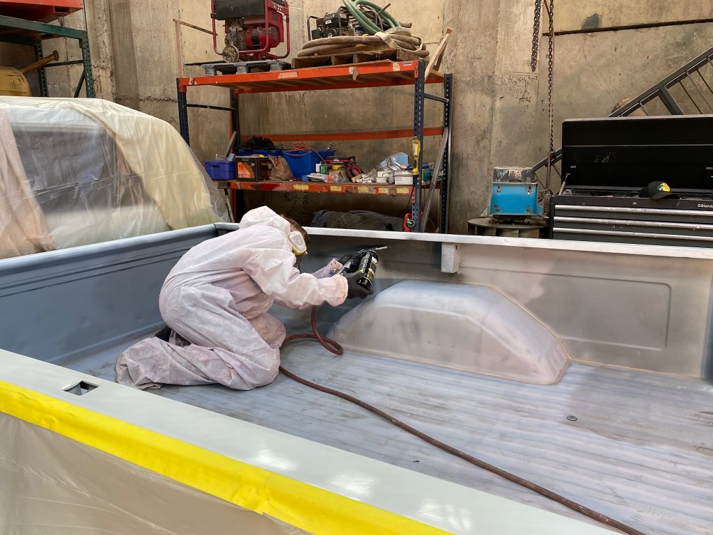

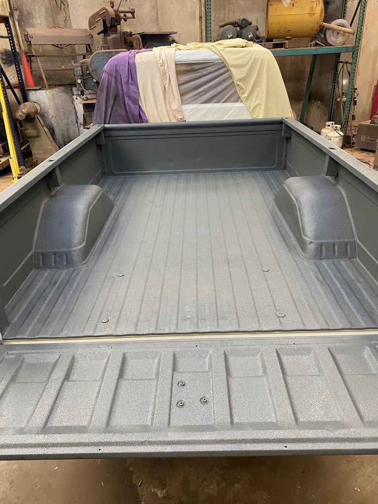

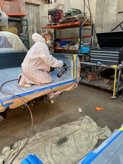

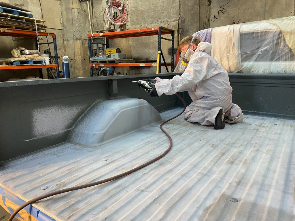

@82sbshortbed how much do you want to spend? Easton did a basic primer and got Raptor liner on Scamazon and sprayed his bed. Been on a year now with little noticeable wear and tear

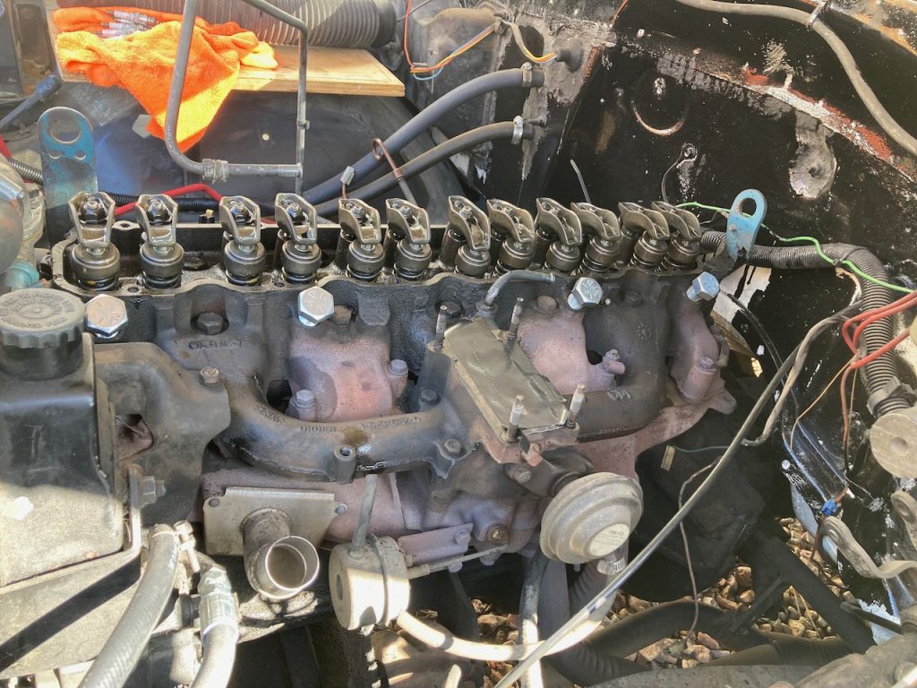

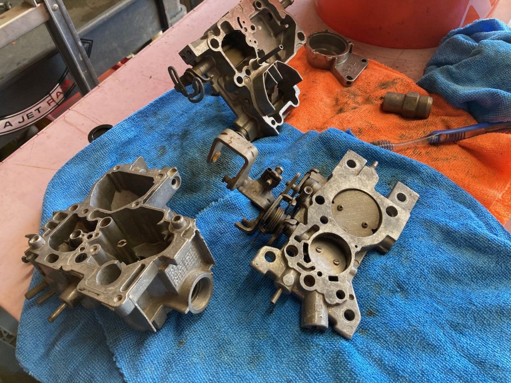

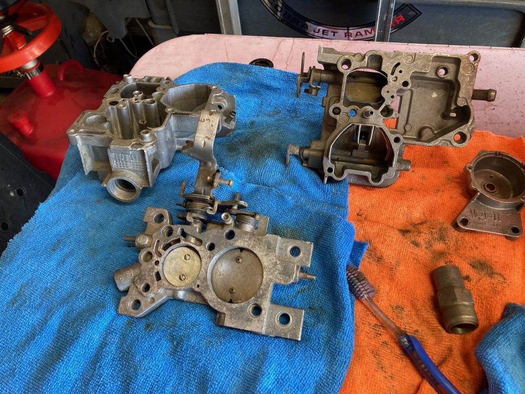

Set the valves, removed the emission air injectors, rebuild the carburetor.
