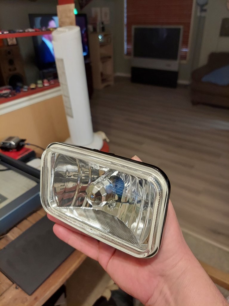

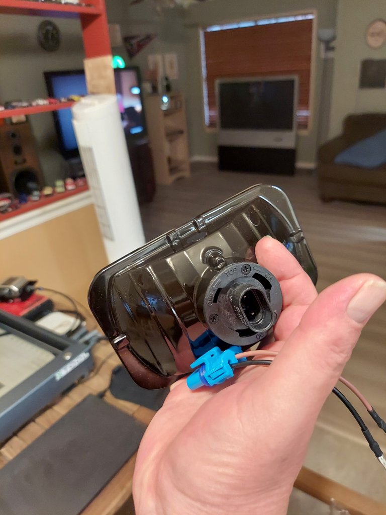

My new headlights from lmc came today. I can't remember who posted the link but thanks a ton! I've been looking for led replacements but failed at every turn. But these are nice and should be able to put led bulbs in them. Made of glass too. I actually thought they were plastic and still bought them. So the glass lenses were a nice surprise. If you have the 4 side by side lights on the suburban grill I'd suggest buying these. It was 180 for 4 lights and 2 bulbs. Bulbs were cheap.

that was me that posted the link. to fit in any 90deg bulb on the outer low beams you will have to trim the headlight bucket behind where the light goes. I did that and swapped to 9012 bulbs. I may go to Diode Dynamics SL1 some day for LED. I'll be curious to hear about your experience if you swap to LED. the inner high beams you will also have to trim some off the core support to fit a 90deg bulb. but the 9005xs bulbs it came with actually do very good at lighting up the night.
