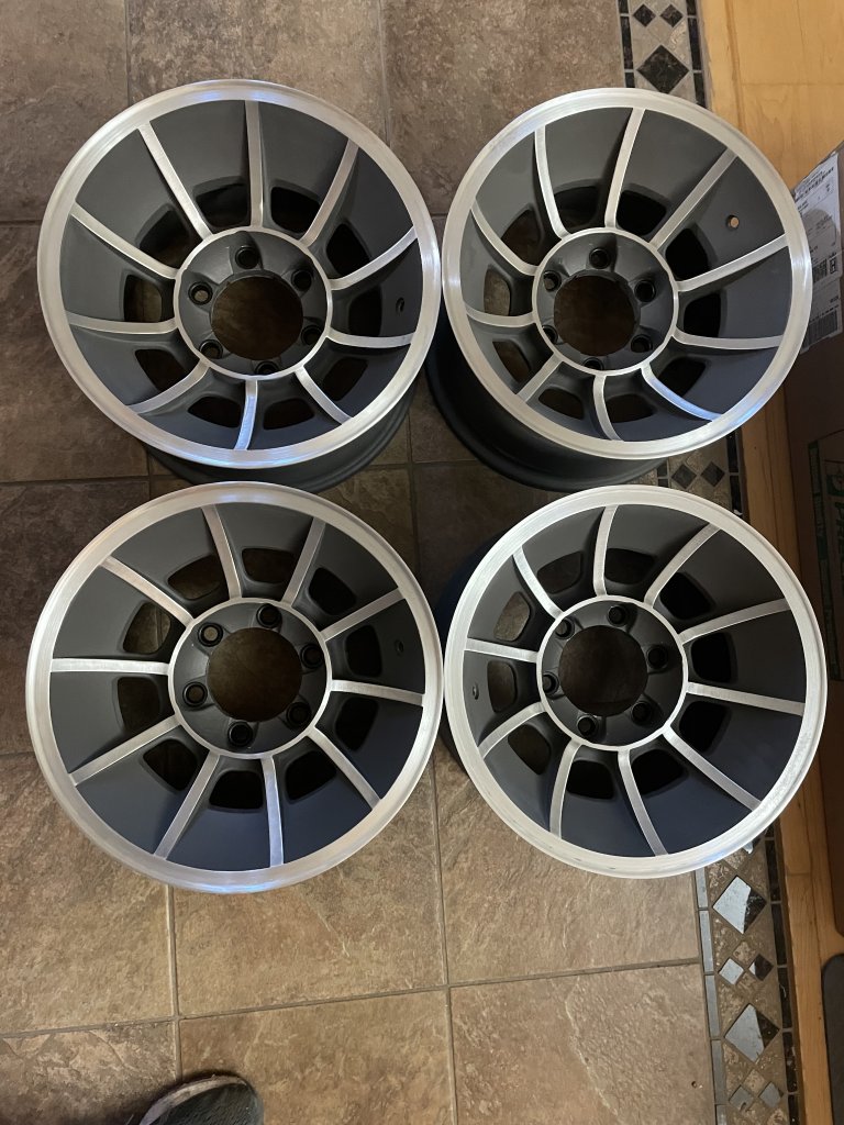

The wheels I sent out for restoration and repair finally came back and overall, very happy with the results. Cleaned then powder coated gray, then the raised portions have a brushed finish. I had asked for machined like factory but the restoration place said it doesn't come out as well on older wheels as the brushed, it ends up with pits from the pores in the casting. They fitted steel inserts to use a conical lug nut compared to the original shanked ones which always came loose and elongated the holes. Tires and centers are ordered.

Those wheels are FKN SWEET!!!!! Fk me I'm so jelly!!!
I was surfing Ebay and came across them, made an offer and the guy accepted. When they showed up, 2 of the wheels were damaged in the lug area, one of them wouldn't even center on the hub. Even though 2 were scrap at this point, at least I had all 4. There are pairs and "3 of them" for sale all the time, getting all 4 matching is impossible. Spent a hour or two researching what to do, called a couple places, finally found one that knew what it was and had performed similar repairs in the past. I may have to install longer wheel studs and the wheels scraped the caliper bracket so need to do some grinding on it but overall happy how they turned out. His price was more than fair but all the shipping made it expensive
