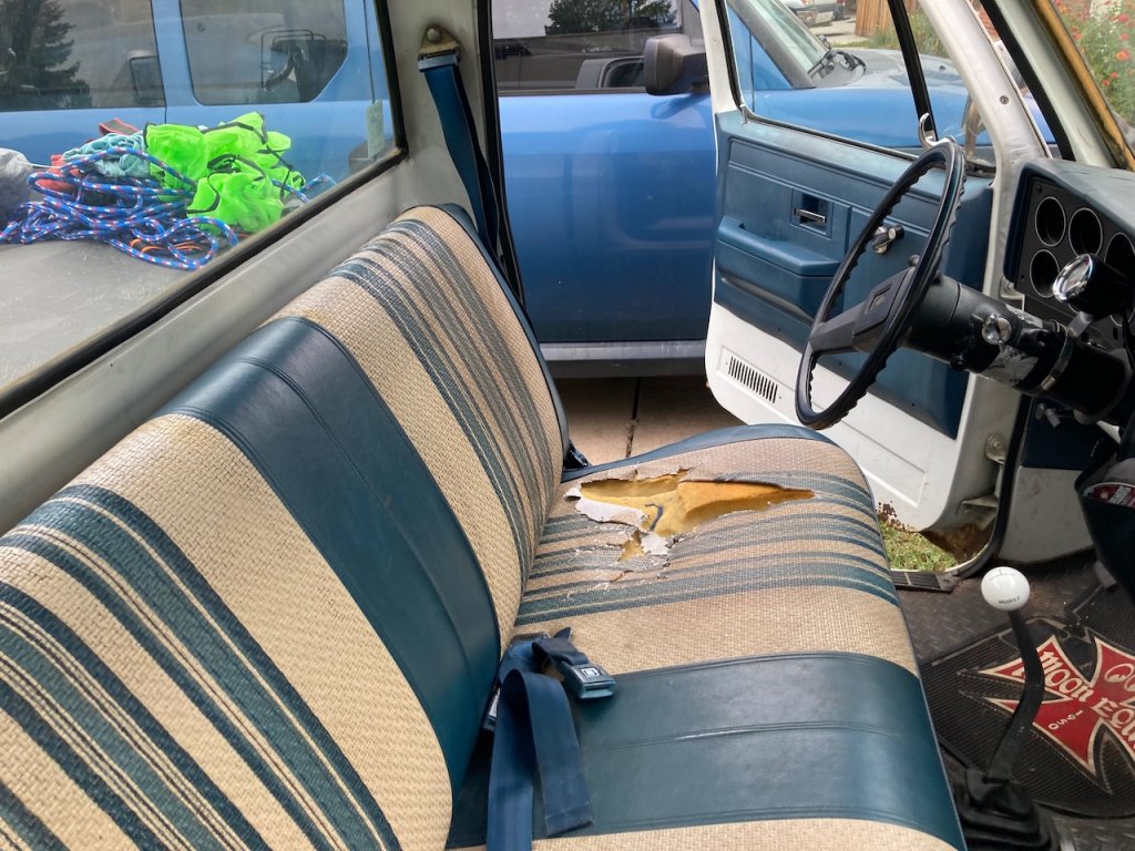

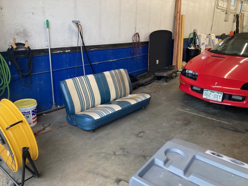

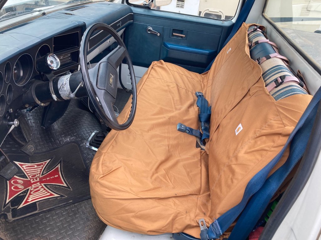

Original seat coming out for new foam and vinyl. 42 years of wear and one crappy cover. Anybody want the Carhardt cover?
That original material and pattern is Great ! I hope you have it Upholstered with the original design.
