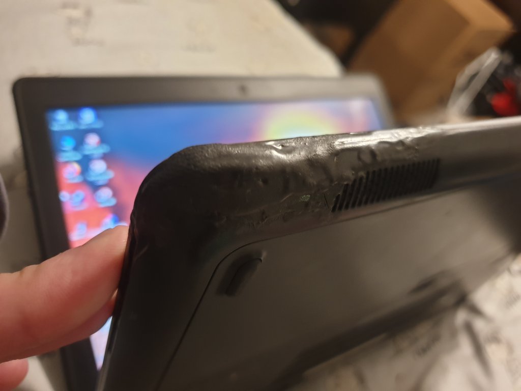

Panel bond should be a household product.
I use it all the time to fix cracked dashes, shoes, and even my Laptop.
(I picked this out of the junk bin at work because it had a smashed corner/shattered screen).
This stuff is great.
