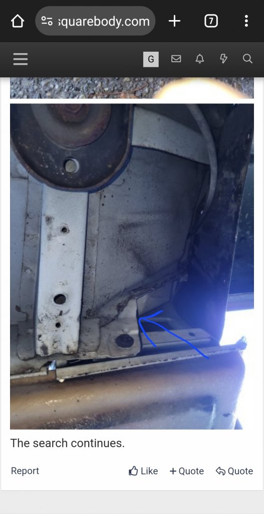

Have fun lenght running boards, so probably that's a d8fference, water seems to be flowing well.

It's been a bit since I have done mine, but I thought the actual drain exit was tucked back farther where this arrow is pointing.

I still think the drains are clogged
at least partially. stuff gets in there and bridges across the gap and water seeps in when it pools up. it is a dirty job to clean/flush/clean/flush until nothing else can be pulled out with a stick. but after I cleaned mine, I couldn't overwhelm it with a 3/4 garden hose running full bore.

Is this the drain, foam was mentioned, I ran some soft wire from the to down and this is where it came out.

been a minute since I've done it, but if you fed something down from the cowl and it came out there, that's gotta be it. I just remember not being able to fit my hands in there very well and using a stick. I kept flushing water from the cowl to push stuff down and using the stick to help pull stuff down and out. and then flushing again, and repeating.
