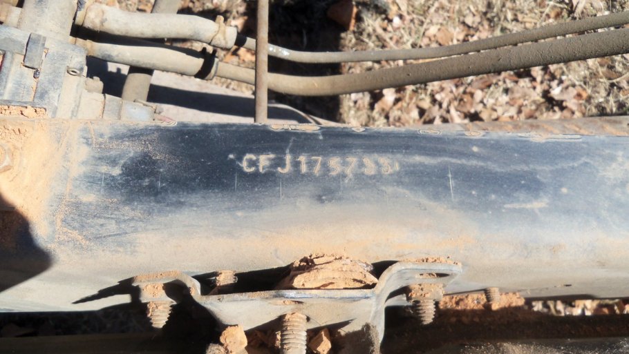

Here's a pic of the partical VIN # on an 85 C20 frame that would be under the cab.
I'm not sure if the C is Chevrolet rather than GMC, of if it's C for C series truck being a 2wd, then the last digits of the actual VIN. If I had to guess, it's for Chevrolet since the part # on the side of the frame would designate a 2wd C series frame.
Also pictured is the part # of the frame and date code on the passenger side frame rail behind the forward section of the fuel tank.

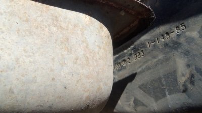

This is the side of the frame- what do these numbers tell me?

Nice clean frame....that is probably a part number... vin is on top flange, pass side near or under rear of cab

My '85 K30 has it on top of the right frame rail in the middle of the gas tank.
Nothing, really.
Part number, date code and supplier information.
(sorry for replying to this old one)
In this case the "C" is for Chevrolet (as opposed to "T" for GMC).
So the partial VIN would be:
CFJ123456 =
C = Chevy
F = 1985 model year (A= 1980, B='81, etc)
J = Janesville
123456 = sequential portion of VIN
A GMC would be TFJ523456, etc
