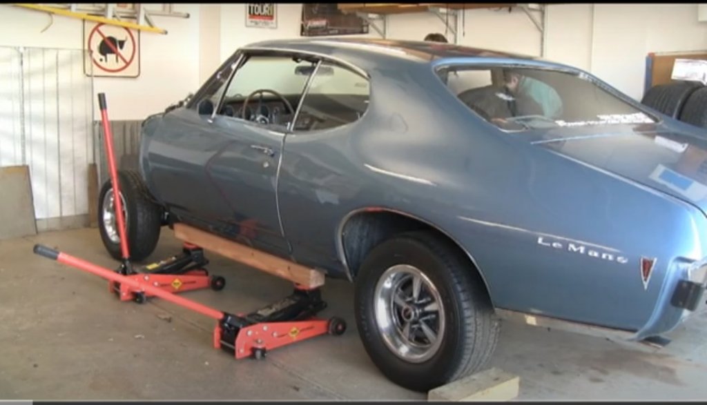

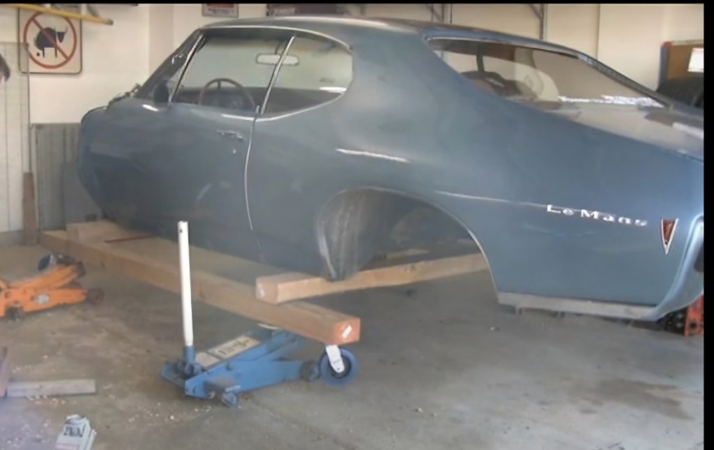

As someone who has dealt with bent and worn out frames, obviously best option is replacement. Depending on what is available in your area, finding a suitable frame might be the biggest hang up.
Replacing frames sounds like a huge deal but most vehicles are plug and play because during assembly entire body is dropped on completed frames. After body is removed rest is just parts swapping and accessibility is excellent.
