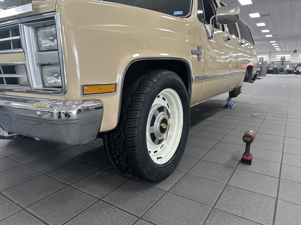

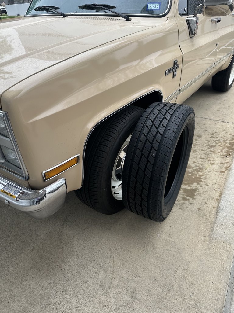

I test fit some 12 ply tires today. What are y’all’s thoughts on 12 ply rear tires and xl front? Thinking of a staggered fitment for these tires for the hot rod farm truck look lol:
Looks good. I personally wouldn't do different load ratings front and back

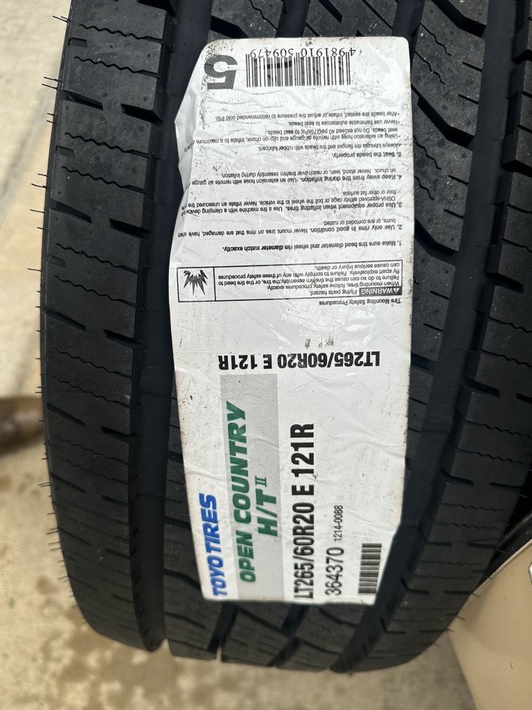

Thanks. I was trying to get the look of these tires while getting at least 10 or 12 ply load ratings on the rear axle. The tires pictured above are too wide for the front 305-50-20 but will work with the rear (and look badass). But I will need to get then 275-50-20 for the front in the same tire but it’s only xl rated to 2833 pounds as compared to the rear at 3400 per.
Would I be better suited to go to a 265-60-20 Toyo open country ht II in load range E all the way around instead of this setup? These rate at 3100 per tire.

I would go with the Toyo E rated all the way around.
