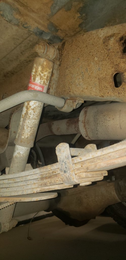

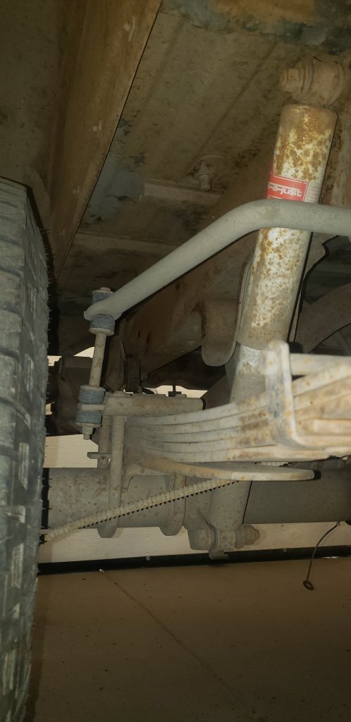

lol, I recognize that rear end. Pics from today came out a little dark but I think you can see it's a basic install.
Homemade end links are angled slightly forward at the bar end because the truck is sitting unloaded, when I carry a bunch of people it droops and aligns better. I kinda remember those J-hook thingies you mentioned but I binned them. I can't remember if I had to drill one or both holes for the L-brackets. It seems like one factory hole was there and I added one more on each side, but it's been too long for my feeble mind to remember.

Thats awesome - THANKS! I was going to ask if you drilled out the holes in the frame. There's 3 vertical holes on each side - you used the top and bottom which is what I was going to do. I think the brackets came with 1/2" grade 5 bolts but the holes are only 3/8" - which I was going to use instead but with grade 8 and then a matching plate on the inside for reinforcement.
