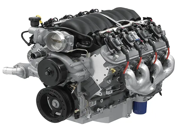

That's what they do when they die.
5,326
8,474
Sh!t can it, put an L.S. in it. and a holley!!!
