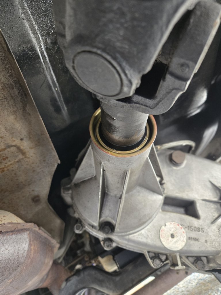

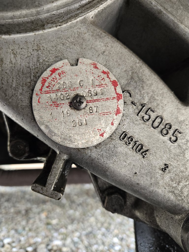

Just did rear seal ended up buying seal puller helped bit time I need to top off trans case do I fill with atf ? That's what seamed to come out ? Also info on case ?

Yes the NP208 cases use ATF.
