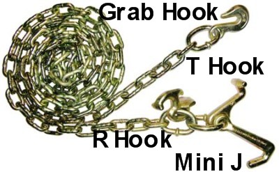

BTW, on a roll back we are to use the 2 finger Ovals in the frame or body that designed to be used as hook points aka anchor points. Every car has them, they are just in different spots, and there are different type hooks for different type anchor points. The big J hook everyone is familiar with like the old school wreckers use, is that, old shcool. Now there is Mini J, R Hook and T Hook. Usually you will have what's called Cluster hooks on the end of your chanis and they have all the different hooks on them. Mini J is the most common, but alot of guys don't trust them and will use the T hook as the most common. A T hook has to be turned to get it in, then turned back and tightened down. Virtually impossible to come out, but a Mini J does have potentional to come out if your vehicle isn't anchored at the right angles and it moves on the deck, then you drop a mini J, and you can potentially lose a car off the back of your roll back. Not a good sight to see.
Here is the chain I like to use. I carry 2 10ft of these,, 2 6ft of these, My bridle on the winch has these 3 hooks on it, and then I also carry 2 10ft chains with the old shcool big Js and T Hook and Mini J on the other ends, and I also carry a 15 or 20 ft 5/16 gold chain with Clusters on both ends. Many times I can use that one chain to anchor both sides of the vehicle as if its 2 short chains. Much faster at hookin and bookin and another piece of equipment I don't have to make sure I have before I move.

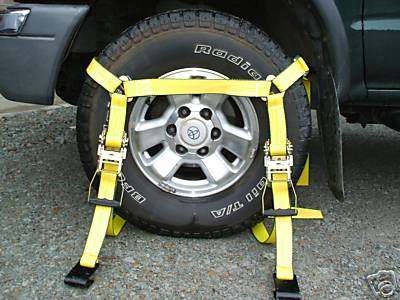

BMW, Mercedes, VW, Some Nissan and Toyota etc, use those eye hooks. I have about 8 different ones because the cars only come with 1, so to anchor at front and rear, you need 2. Are we allowed to use those? To get the car ON THE DECK AND LOADED ONLY. Then it's to be anchored with alternative methods like straps at all 4wheels. My bossman doesn't even supply us with the stuff, so yes, we do it illegally, and against mfr suggestions. I do throw a safety around an axle or something solid. Granted it's going to tear up the car bad, but it beats having one roll off the back of your truck.
