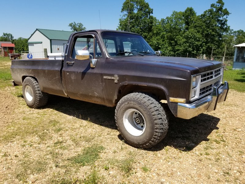

The 33's on 16" rim clear fine been driving it like this for years. My problem is I want that lifted look but with the 15" stock rims. Can't find a tire bigger than 30X9.5. I'm afraid they would look too small. The truck drives great with the 33's.
35x12.50 on 15" rims
245/75R16
good luck
