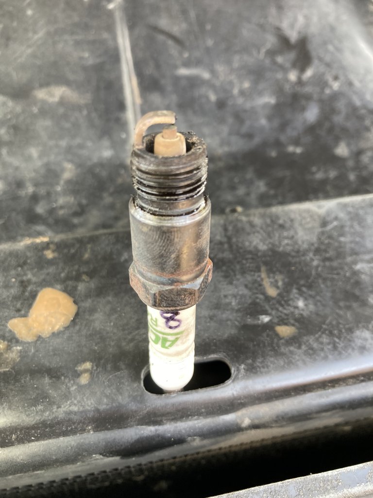

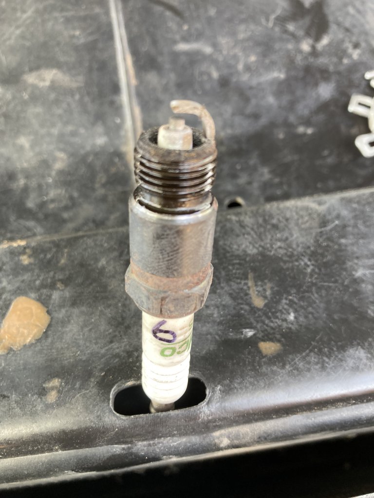

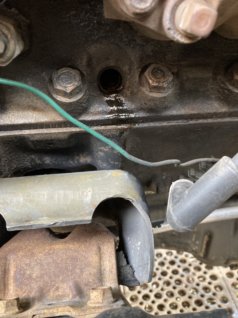

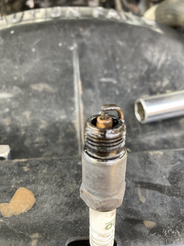

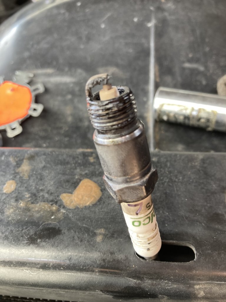

What makes you say the plugs and wires are good? Are they new? A compression test may be good for diagnosis as well. Rest of the plugs aren't too bad but need to be replaced. Cylinder number is on the plugs.
Found this on number 3 today. Plugs have been clean and dry until now.

Yeah, I'd do a compression test to verify if there is a dead hole.
A set of plugs will probably help a bunch and if #3 becomes a problem again, you can run an anti-fouler on that plug.
