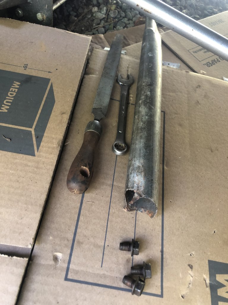

Yes I got the three tiny flywheel bolts off definitly needed all three tools and the 15mm wrench needed a cheeter pipe and large file to wedge the fly wheel

now you can push the torque converter back into the transmission to make sure it doesn't catch on anything and get drug out of the transmission when you pull the engine. It should go in a little less than 1/4"
YES! Don't forget this small detail.

A cheater on a flexplate bolt, someone tightened it too much. At least you got it loosened up and ready to pull.

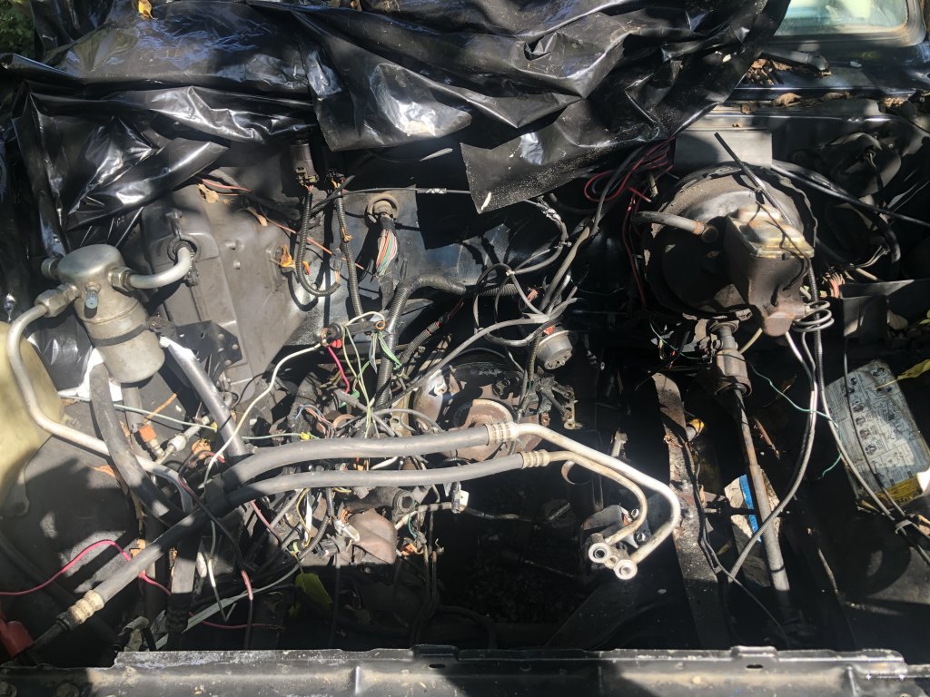

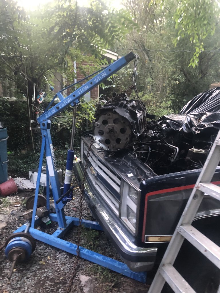

Got her out I cracked off a chunk of where the upper bell housing is bolted to the block hopefully not a big deal .

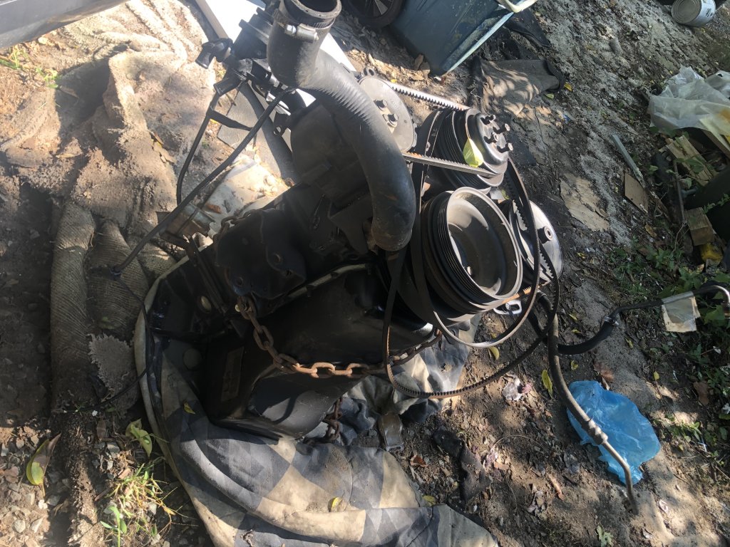

I’m either going to have to do this myself with is old engine and or do you think I could pay under $3500 to get someone to plumb back together and install a rebuilt 350sbc ?
