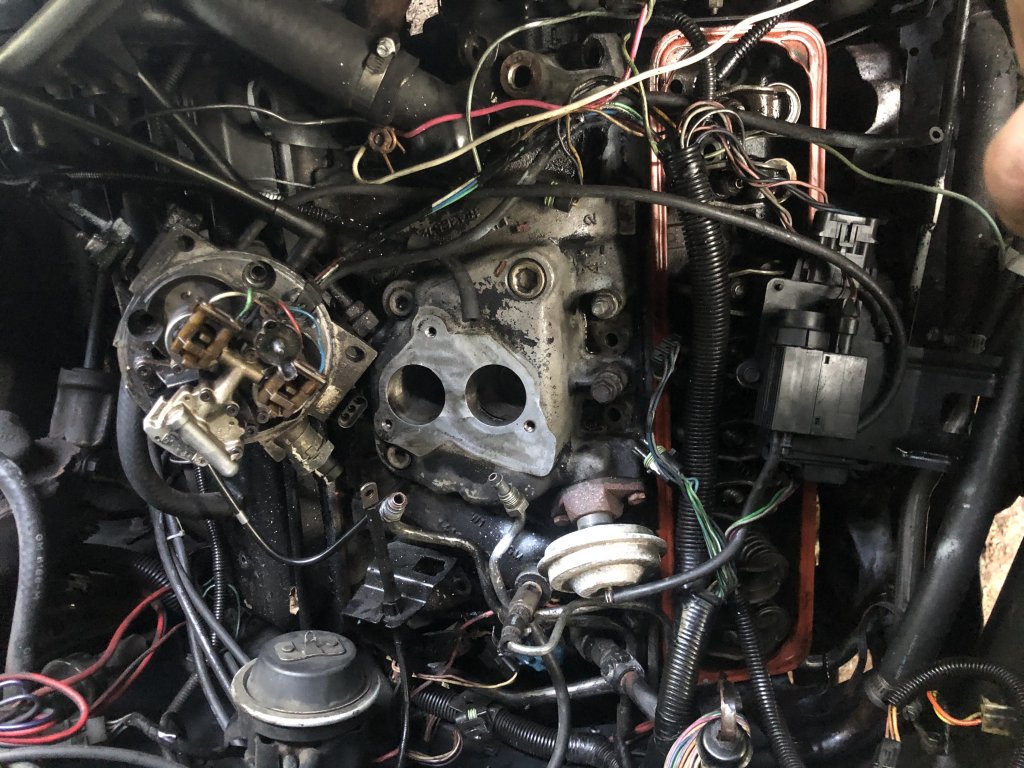

Ok what else do I need to remove to get this head off I can’t get the intake off even though I’ve removed all bolts almost
I think the two bolts next to the TBI base still have to come out.
well ALMOST isn't all of them. And even when all of the bolts are out, after years of heating ad cooling and old gaskets and pins and whatnot, things don't just pop off once all the bolts are out. Sometimes you literally gotta whack it with a hammer to pop it loose, just put a block of wood in there or use a dead blow so you don't crack anything...
