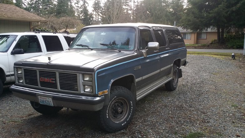

Ok...pics are uploaded! Nothing of note, just a 2500 Suburban that serves me well.
Significant find today: since it wasn't raining when I got home, I thought I would do some more troubleshooting. So, I first disconnected the ESC module and started the truck-same surging in Park. After reconnecting it, I then unplugged the MAP sensor and restarted-NO SURGING! The idle was a bit lower, too. Now, that MAP sensor has been replaced recently and it was surging before and after the replacement so what does this mean? Aftermarket poor quality? I can get an AC Delco unit and put it on the truck easily enough. There seems to be a question around the GVW >8500lbs (I'm pretty sure mine is over that in rating) in terms of which MAP sensor would be the correct one.
Any thoughts from anyone on this?

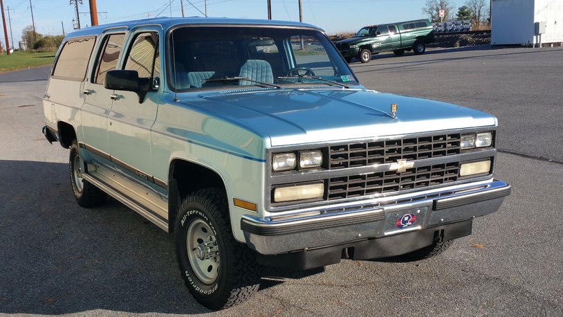

My 90 4x4 350 1500 with 198,000 would ping like crazy, lurch at stoplights, sputter, stall when put in gear quick and wouldn't climb hills. I had it to a Chevy dealer and they changed avac line and said their tech road tested it and it's fine.
It wasn't.
I took it to the radiator ship in town that head a guy that remembered working tbi's back in the day. The tbi and intake gaskets were shot shot and he cleaned out the egr. It runs like a new truck.
And he painted the intake :)
Tom
