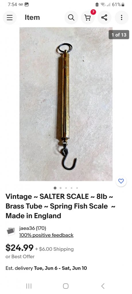

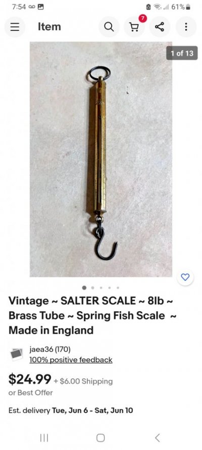

@75gmck25 ) Spring scale like these? For example. Depending upon what weight was spec.

That is the type of spring scale you use, and from what I recall you use it to measure the turning resistance of the box arm.

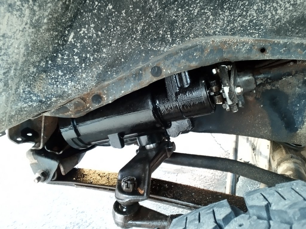

Dude I have been very happy with the LARES brand box I put in the 88 Blazer because it is Tha Shizznit.
Factory steering ratio is 7.8/1
A (1988) Z-28 box is 12.5/1
A LARES box is 16/1 and it bolts on.
Bout twice the price of a parts store rebuilt = Choose wisely.
Hope this helps!
