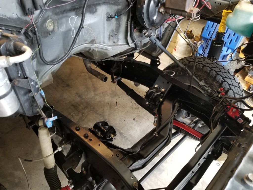

I used the Redhead box and the Borgeson U-joint link. I love them both. It drives much more precisely. The Moog ball joints however, are tight as a nun's a$$. When they wear in it will be even better.
Reminds me of an old joke about lug nuts. You might want to recheck those ball joints.
