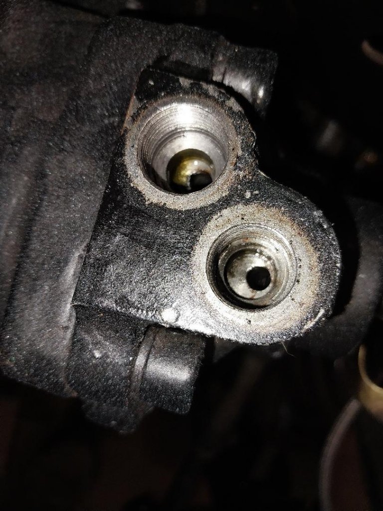

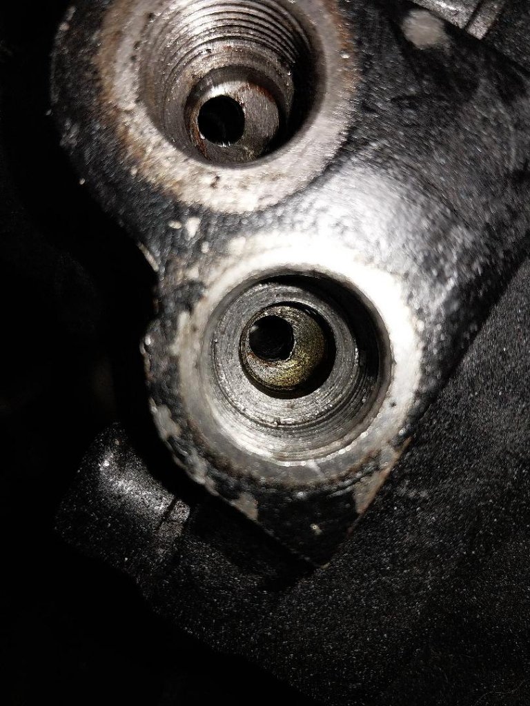

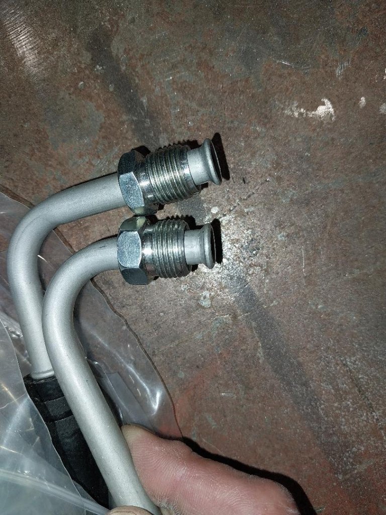

Yah, you might have to buy adapters and switch the lines with custom fittings.
Swapped the power steering unit to use a 1981 Camero small block pump mount on my 1994 block with Vortec heads with headers.
Had to switch the tank screw line fittings pump side, to continue to use the metric o-ring OEM lines on my steering gear.
The old school 1981 P/S unit which clocked a bit towards the water neck, was what would fit with a custom 1/4 fab plate to the head.
I found a couple donor P/S units and when I re-sealed & re-bushed a known good 1981 Camero pump, the internal threads from my 1987 and 1999 GM pumps, did match, despite the external fittings going to metric o-rings.
YMMV
